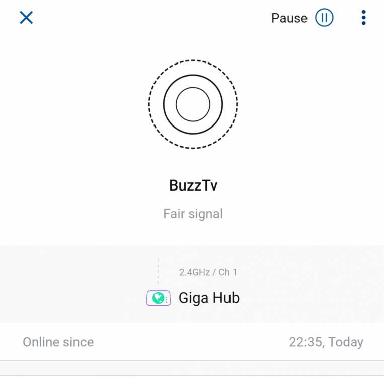

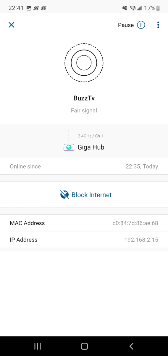

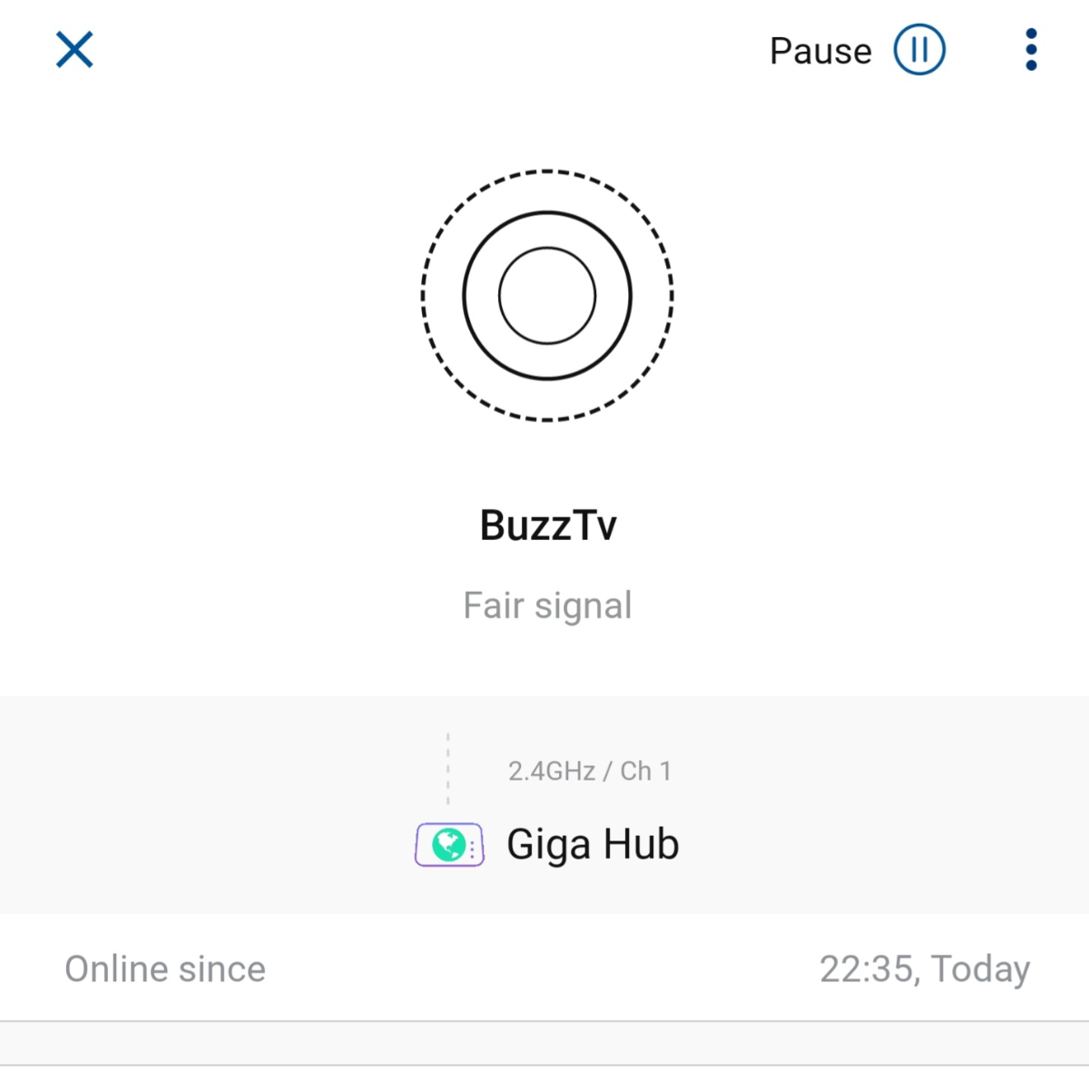

I have the same problem.
My Xps4500 connected through the wifi.
As you can see its connected on the 2.4ghz
eventhough everything else connected on the 5ghz.
The distance of the buzztv box to the router is no more than 7ft ( around 2 meters).
I did many restarts to the box and the router, but its not helping.
Edited by TENSER007
Is that a Bell HomeHub ?  If you absolutely want to connect  to 5Ghz, I suggest you disable the built in band steering on those stupid integrated router/modems provided by Bell.  Under WiFi, in Advance settings, you probably have some options to to allow you to split them and to rename the 5Ghz band (add a "-5" or something to it to distinguish it from the 2.4).  Actually many IoT devices need this option done, but for the opposite reason (since they need 2.4Ghz, but they can't see it sometimes with band steering enabled).
Doing this, you can ensure you are connecting to the 5Ghz band, without allowing the dumb modem/router to make the decision.
