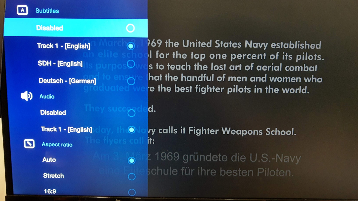

After trying a few, I decided to try some of the 4k streams (figured most scene releases put a little more love into their 4k releases and all bundled into a single mkv container).  Well, first 4k movie I tried (T0p Gun M@verick) seems to have a few sub tracks included (see screenshot attached).
The non-4k version, did not have any subs included.   So the screenshot pretty much confirms that BuzzTV does support subs, if the stream has them embedded.  For reference, I was using the primary player for VOD.

I have tried 4 servers and the TV Series do not have any captions on any server I tried (there may be a few, but I did not find any on the ones I spot checked).  For VOD movies, most of the older movies have no subtitles encoded.  I did find a few big titles that had some subs encoded, but even those, you had to go up to the 4k encoded version, since the basic 720p or 1080p version were super basic with no subs.  Example, T0pGun Mav3rick I checked on 2 servers and the basic HD version played fine, but no subs available.   Selected the 4k version on both servers and they both had a few subs available in different languages.  Having "downloaded" many of the VODs, and then checking the metadata properties, I can tell you that most of the movies no VOD servers are typical movie scene releases (ie: the ones you find on torrents and/or usenet).  Depending on the server, the version they have is better quality than others, but most have at least the 1080p versions.  This is not a bad thing, there is no point in re-encoding/ripping something that can easily be downloaded elsewhere, but if subs is something you "need" then you would probably want to find a service can offer you what you need.
Here is the TG Mav in 4k, and you can see it has 3 CC tracks.. One for all English everything, the second English is for "forced english" for foreign language scenes, and in "Ggerman".

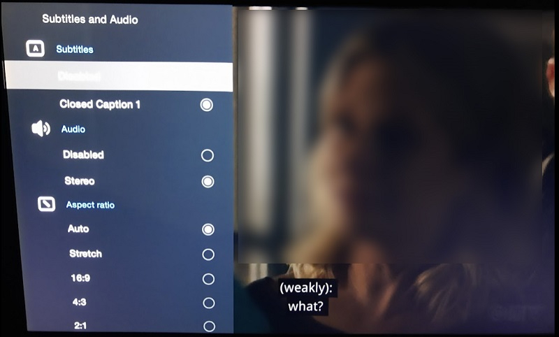

Now for TV, it is very dependant on the source that is used and if the provider decides to pass it along.

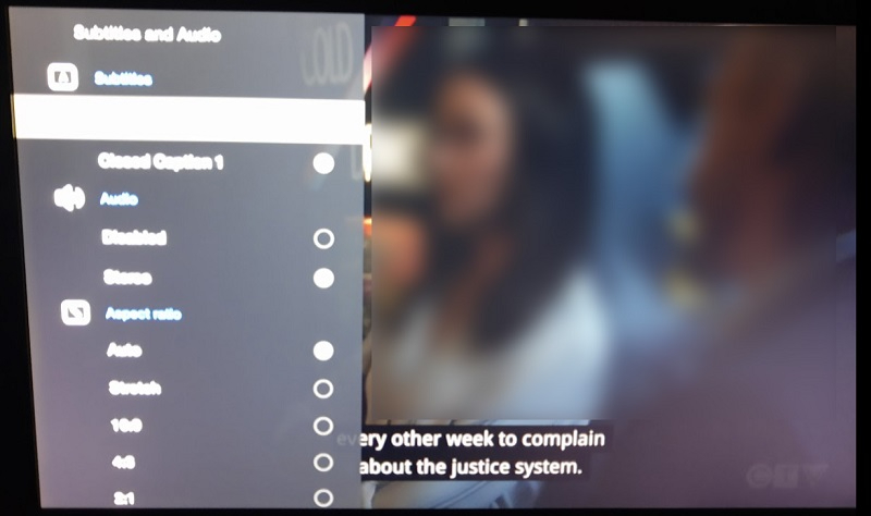

Here is CTV on one of my servers (my main one), and it has 1 CC track, and when I select it, I get subs without an issue (as you can see below).  I have other services, where the exact same channel, does NOT have any options for CC.
So bottom line, is that it is 100% dependant on your server.  The BuzzTV box will detect and allow you to watch them if they are part of the stream.  So if you want subs/captions, then time to start looking for another server.
