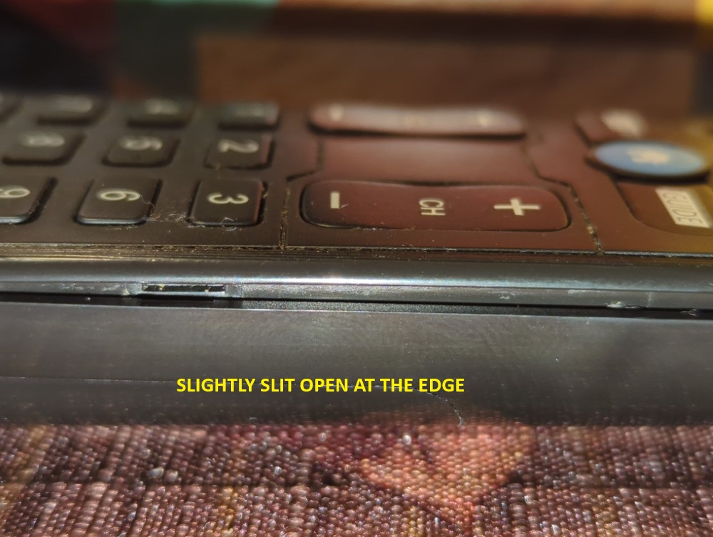

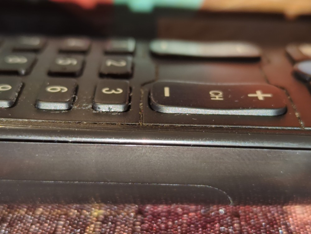

For the remote, when I mentioned earlier about dropping it, it is not always a drop.  Sometimes it can happen if for some reason someone sits on it, or rolls over on it (plenty of mine split open on occasion if I forget them on the couch and site on them).  It is very subtle if you are not looking at it from the side, so you may not notice it, but it raises the plastic ever so slightly that the buttons are no longer "raised".  Anyhow, you can see the pics attached, First one is slightly split along the edge and you can see the buttons are flush because of that.  The second pic, with it squeezed back together the buttons are raised, making them easier to use and more responsive.  Anyhow, just something to check, since I have had 2 friends who have had that issue, and we got a good laugh when I went over and just squeezed the remote back together.

Cover is intact.  It has never been sat on, rolled over on, dropped, had anything spilled on it.
