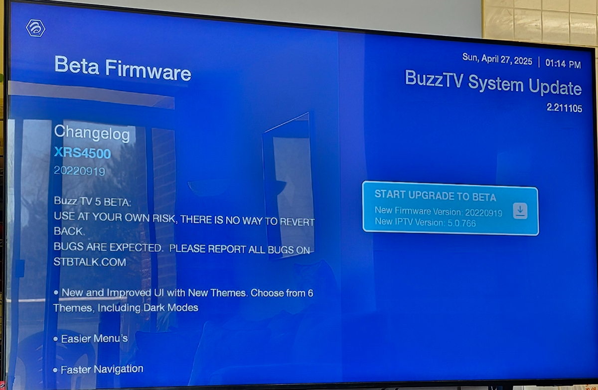

@Emporium, Entering 2015 worked but, it is giving me serious warnings that it's a Beta version and I should install it at my own risk and there is no way to revert back. I'll try and attach an20250427_131457.thumb.jpg.b122ac9d006216e031560214e47dca0b.jpg image.
Yes, you have an xrs4500, and it is running BuzzTV 4 (IPTV version is 4.0.530 as you mentioned).  This will update the App to BuzzTV 5 (IPTV version 5.0.xxx).  Don't worry about the warning.  BuzzTV 5 has been out of beta for years, so it will update and then take a few more updates afterward to come up to the versions I mentioned.

It worked guys! I am running 5.0 now. Tons of thanks to @dishuser, @nbs.and @Emporium. Other than the cool look any function worth mentioning that came with this new version?
it shows you in the pic you uploaded 😉
