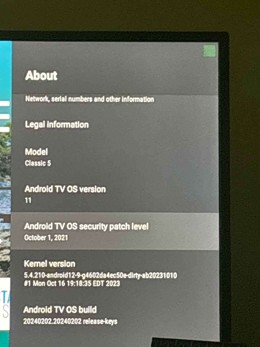

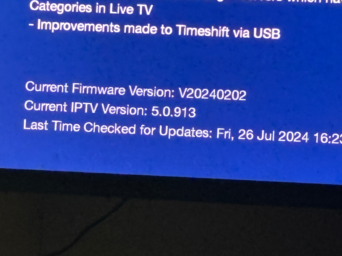

I have a Buzztv Classic 5. Last update was 2/24. It’s OS version 11. Firmware version V20240202. IPTV version 5.0.913. Why don’t I have a June update yet?
From Live TV, did you try to go to Menu->Settings->Check Updates ?  Do you get any message on the bottom when you press it ?  If so, what does it say ?
V20240202 is the correct latest firmware for the Classic.   But the S/W version should be 5.0.935.

Hello. When I did all you said Emporium (thanks for you quick response). It starts to update but the line on bottom of screen does not completely download,  but it says it updated. When I check it’s still same S/W version. 😣
