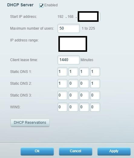

This is often a DNS issue.  Most ISP are crap when it comes to their DNS servers.   Change your router and set something like 1.1.1.1 (cloudflare) and/or 8.8.8.8 (Google) as your DNS servers.  And ensure that your router is supplying that to all DHCP requests downstream (like your boxes).  That way, your ISP has no say in what you are resolving or not.
Thank you I will give this a try and I also might try to input the M3U also

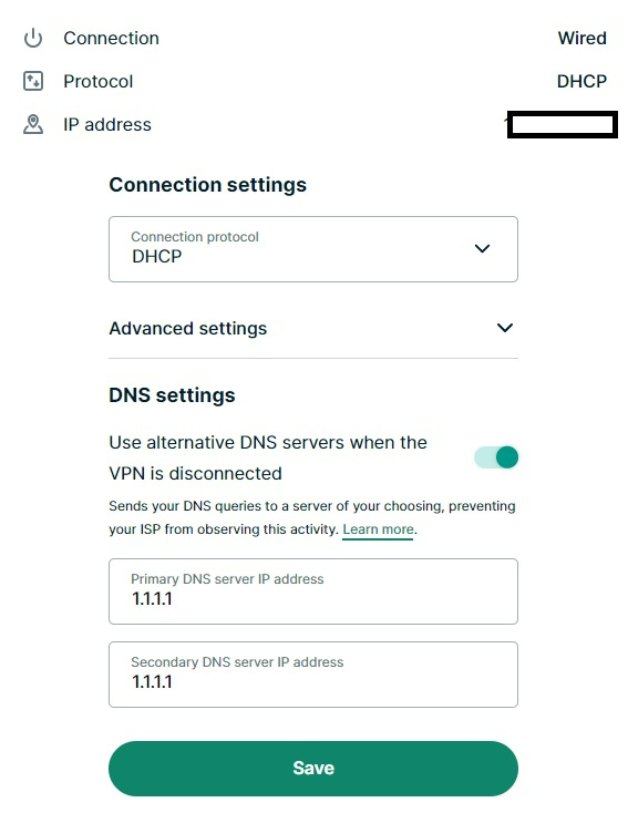

Emporium I just changed my main router's DHCP server settings to 1.1.1.1 I found it following a Youtube video but when you mentioned to supply it to all DHCP requests downstream my vpn is not showing in this setting it's being fed the net by the main router and only the boxes are connected on the vpn route. I've attached 2 pics for you this is a little out of my scope but willing to work on it to keep my stuff private and my provider out of the pic none of their business. Both routers are Linksys not sure what the vpn has Express Vpn load the firmware I think it's tomato

tomato vpn config has options for DNS as such (I believe under advanced, and "Accept DNS configuration"):
  • Disabled = DNS servers sent by VPN-provided DNS server are ignored
  • Relaxed = DNS servers sent by VPN-provided DNS server are prepended to the current list of DNS servers, of which any can be used
  • Strict = DNS servers sent by the VPN-provided DNS server are prepended to the current list of DNS servers, which are used in order (existing DNS servers are only used if VPN-provided ones don't respond)
  • Exclusive = only the VPN-provided DNS servers are used
I guess you'd have to set that to "disabled" to allow the router to ignore DNS servers from espressvpn.
*** However keep in mind, using DNS servers external to your VPN provider is considered a "leak" and therefore not 100% private, since your DNS queries are going to 3rd party servers.  I personally don't care, but just saying.
