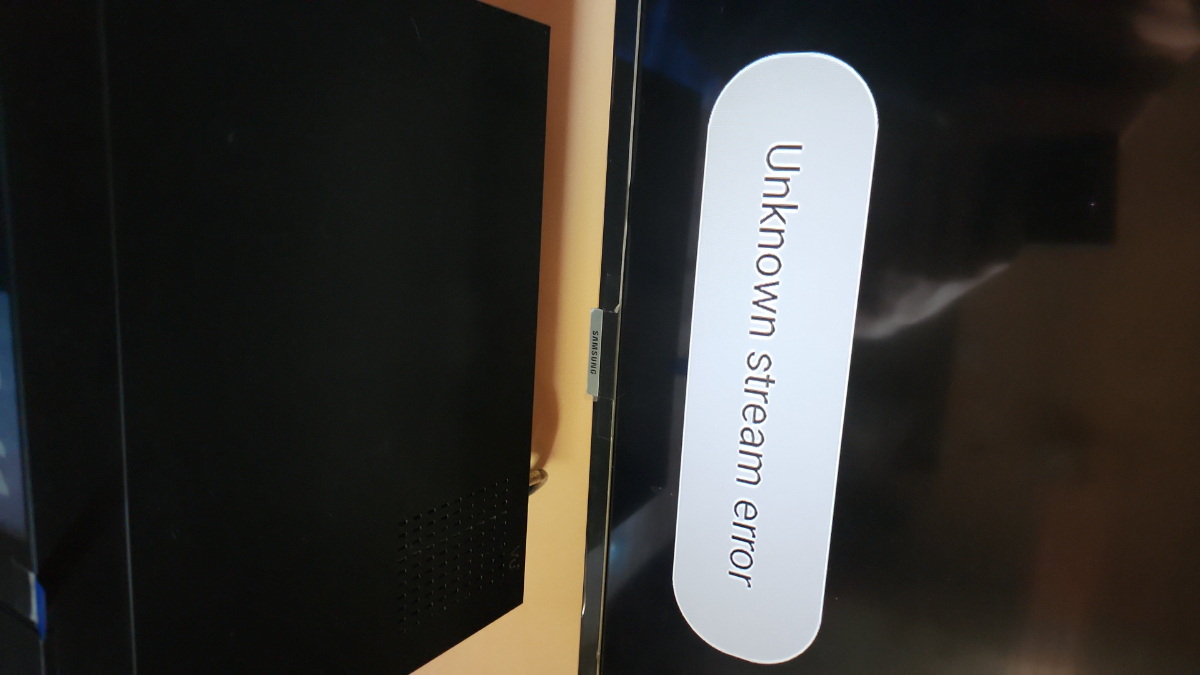

After updating to the latest firmware, half of the channels show half no, it gives an Unknown stream error, why did it happen?
1 hour ago, Opazzno_NooB said:
but how to do it? I don't know, tell me.
Going from memory, since I am not in front of my TV, but hit the "menu", "settings", "Configuration", and I believe it is the first option for LiveTV Player.   depending on your version of software, it could say "Primary", "default", "Backup, "Secondary",etc.. there are 2 options.  Select the other one of what is presently selected.
