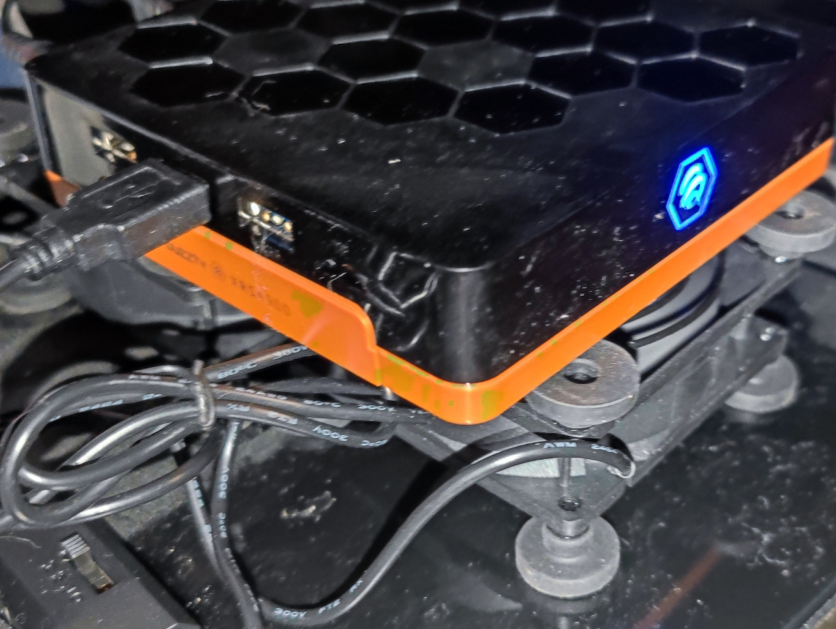

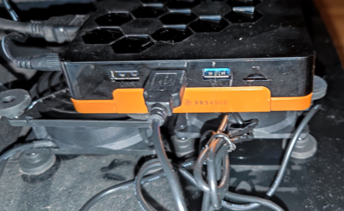

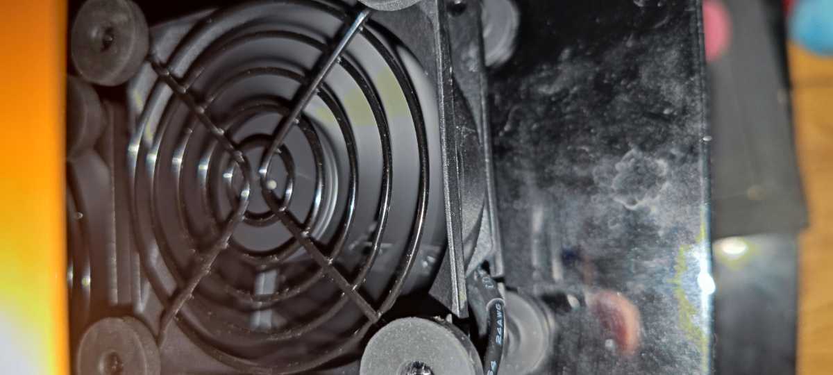

I figured out a fix without changing my drive.
$15 makes the box cool
Better performance.

Is your XRS 4900 is an open area and elevated off of a flat surface?
If not, I purchased a 4'x4' usb fan that plugs into my unit.  Check Amazon.
