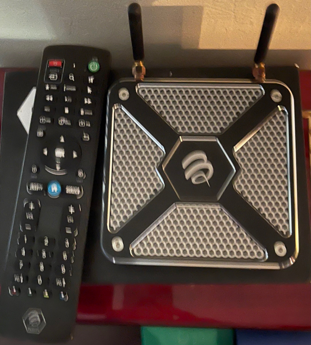

I did everything I think it is your WiFi external defective I would like to get it fix or trade I have sent pictures of this unit but tell me what do I need to ship I got even box it came
You will need to contact cs @ buzztv.com and explain it to them if you need to return for potential repair/replacement under warranty.
Did you split your Wifi to 2 different SSID to force the router to split the 2.4Ghz and 5Ghz to different SSID ?
What router are you using ?
