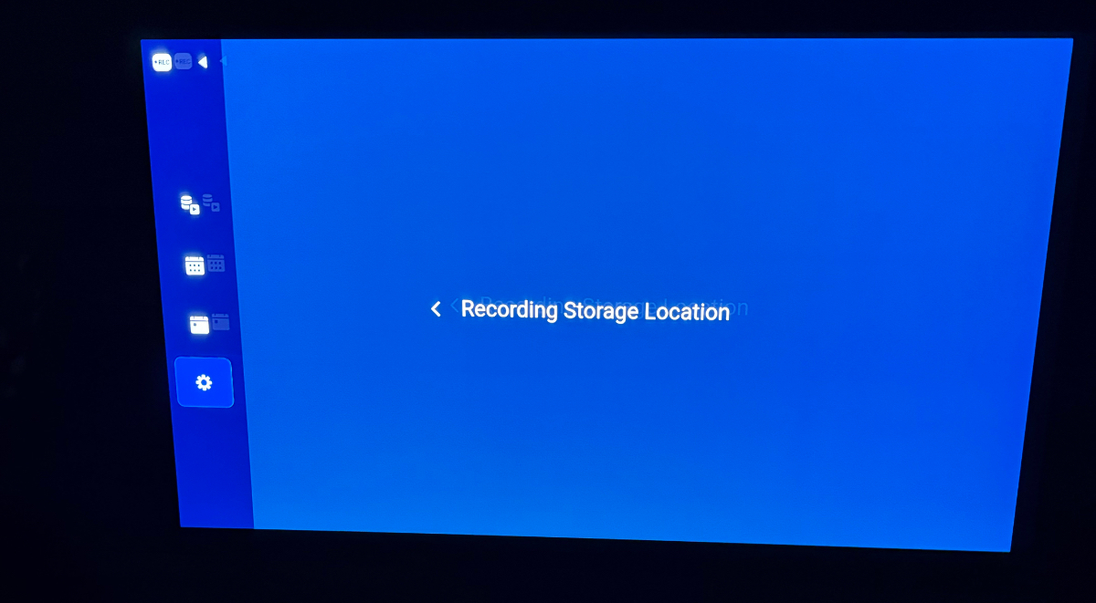

it won't let me change where to record to. it freezes when I go to select storage. It isnt seeing the internal storage. I have to go back to main menu/guide. It is locking up for any recordings. Seems to be the box??

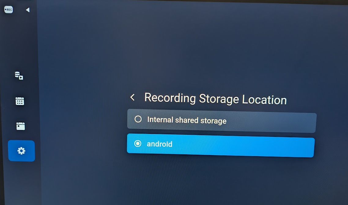

I just checked and I have internal showing and "android" which is a small 250GB NVMe I have installed in it.
And if you go to Settings->device Preferences->Storage you don't see the "Removable storage" ?
