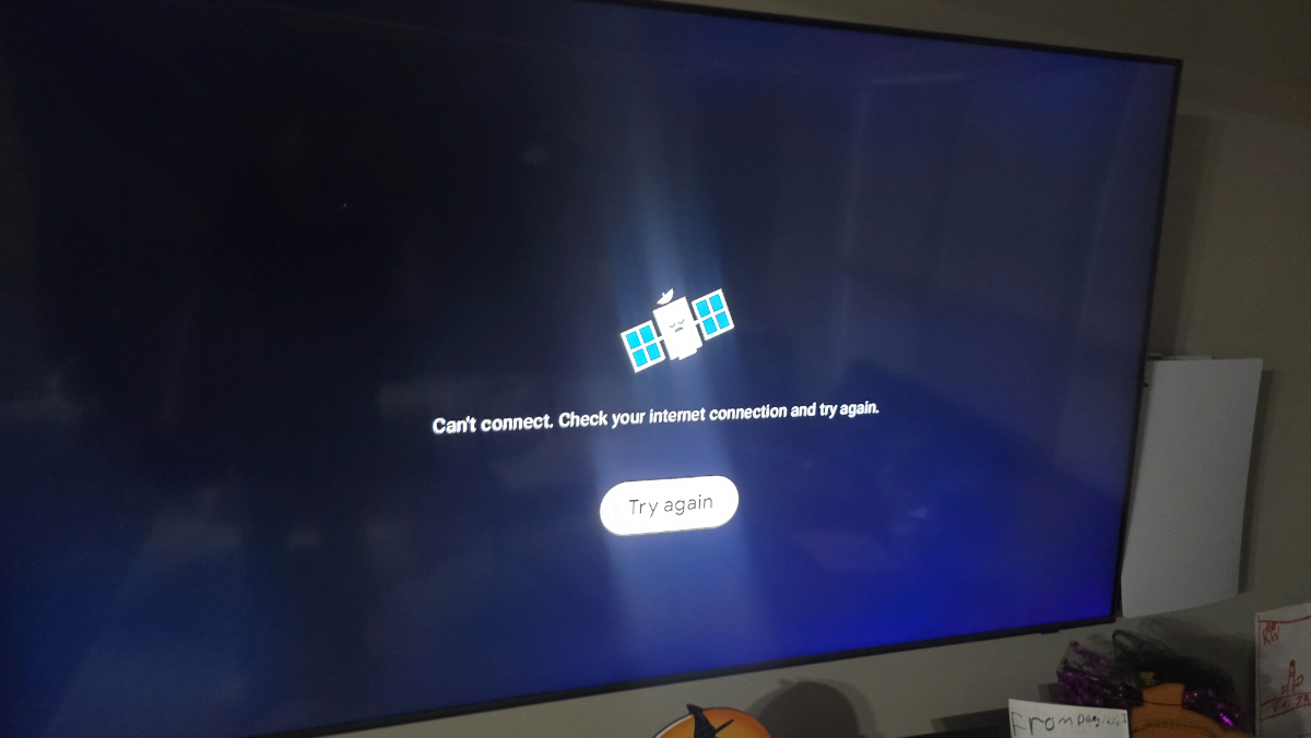

google play store issue
hey guys is anyone else having an issue with the google play store when I click on it it says this device is not connected to the Internet but I'm connected via ethernet and every other app is working just fine when I clear the data of the google play store it will start working again but only for a short period of time I've tried deleting my google account from my device and re-adding it and seeing if that works I've also tried clearing the cache and uninstalling the updates for the google play store none of those things make a difference and like I said the only thing that works is clearing the data of the app

I spoke too soon like I said before every other app is working and there's nothing wrong with my Internet
