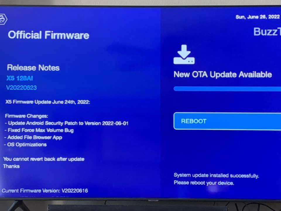

Downloaded.
Update finished.
Reboot.
Screen stuck on logo for hours.
Unplugged and plugged back in.
Screen stuck on logo for a couple hours before unplugged again.
Same results. Ughhhhh!
Brick?
15 minutes ago, Rusty Ellis said:
Downloaded.
Update finished.
Reboot.
Brick?
when was the last time you took a firmware update?
2022 was the last time it told me to update.
I unplugged the unit last night and the plugged it back in when I woke up this morning. Same logo on screen and nothing else.
You need to contact buzz
Cs at buzztv.com
Give them the firmware on your x5 and they should be able to help you

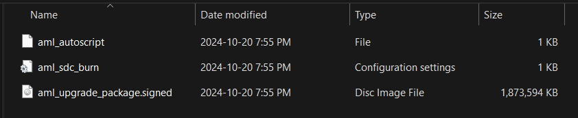

Did you install that firmware via SD card and ensure that only three files were in the root directory?
you can have more files in root directory
you just have to make sure that includes the 3 needed
The card was blank aside from the files below-
Correct, yes - only the files pictured here were copied to the FAT32-formatted 32gb Micro SD card
1 minute ago, dishuser said:
did you unplug and push and hold reset button and plug back in?
Yes, following the instruction video, I removed power from the box, held the button with a toothpick while plugging it back in, and released the button after 15 seconds.
The box sat for an close to 2 hours with no change in light color or video output-  solid red LED and black screen.
