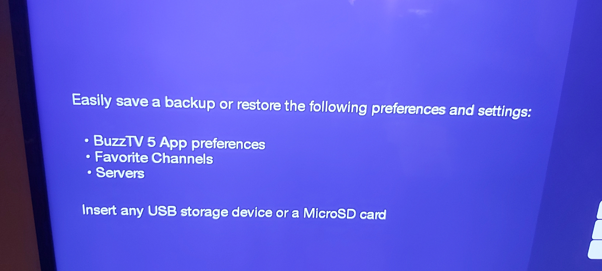

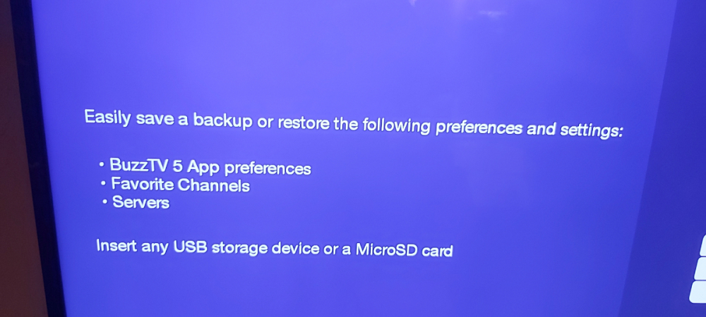

4 hours ago, nbs. said:
also read the replies here as well
Emporium told them what they can back up
