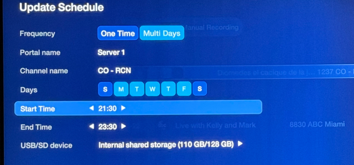

  1. this is what was working before latest update . now it stops after first 30 minutes. I am going to try it again is the bug in multi days perhaps ?
  2. No, it is set to record the same channel for say 1.5 or 2 hours but spanning several different program schedules. It will stop after first half hour.
  3. "In the Scheduled Recordings Menu and using Create Manual Recording" That is what I use
  4. To solve the problem I set it 90 minutes and that way I record more than 30 minutes
  5. It was working in the previous version
  6. I am using the Schedule option in PVR. I select the channel , start time and stop time. example: If Program A starts at 7 pm and ends at 7:30 pm Program B starts at 7:30 and ends at 9:00 pm I use start time 7 pm and end time 9 pm. It will record from 7 to 7:30 ONLY.

  10. It affects all recordings. I just setup a 1 hour recording and will let you know if it worked. My device is brand new but if necessary, I will reset later.
  11. I overlooked the END DATE . It works advancing the End Date. Thanks The recording using the SCHEDULED feature can be set up for more than 30 minutes but it only records 30 minutes. Let me know if yours works.
