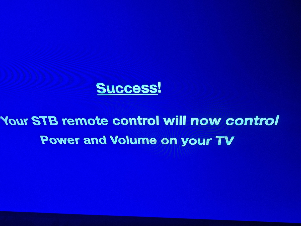

U5 HDMI-CEC issue -> can not reboot or shutdown the box
After launching Auto TV setup and configure the sound option you can not shutdown/reboot the box anymore with the power button of the remote. Because the power button of the remote shut down the TV and not the box (after launching the Auto TV setup, before all works fine). The HDMI-CEC from TV send the shutdown signal to the box.
To be able to shutdown/reboot the box, the power button of the remote should send the shutdown signal to the box and the box should send the HDMI-CEC shutdown signal to the TV.

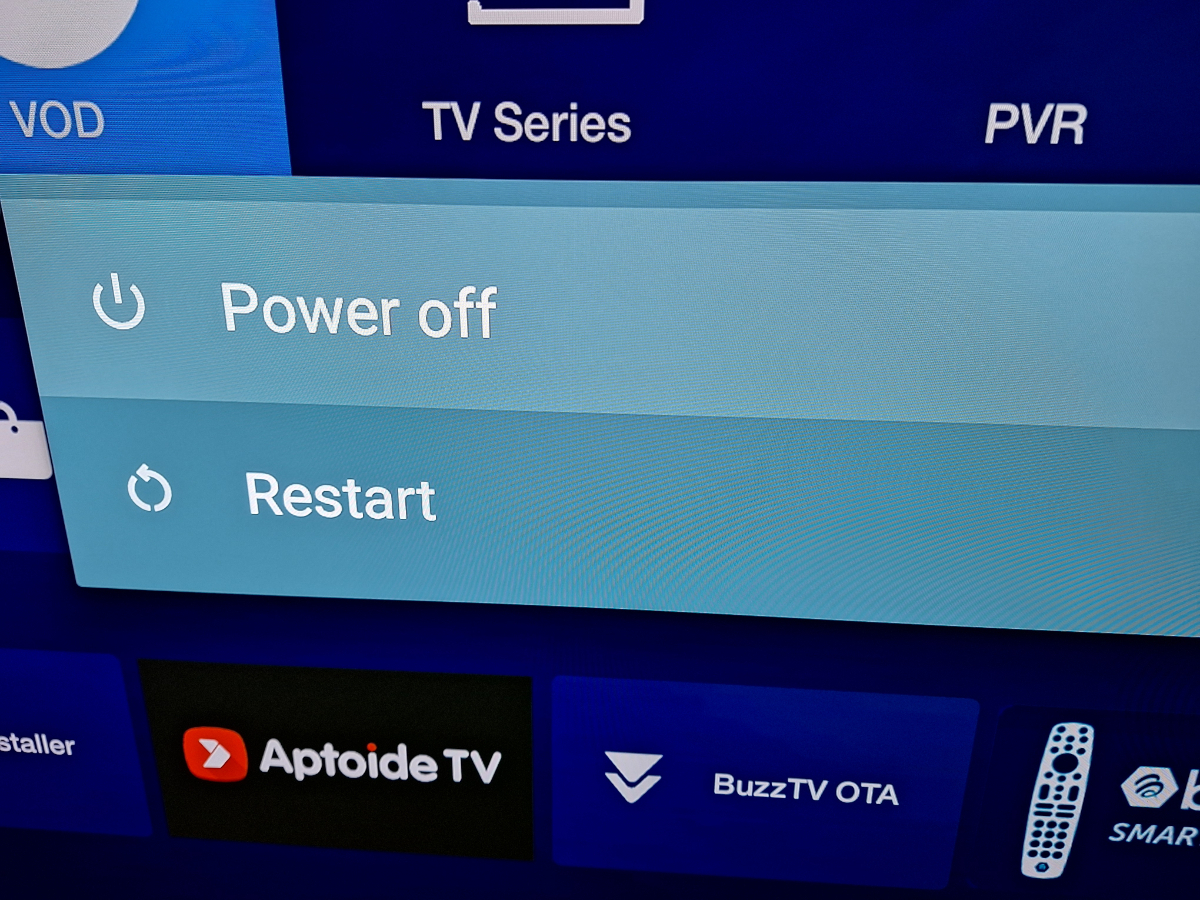

I will ask the question in another way.
Could you please explain me how to get the same menu like in picture with HDMI-CEC enabled AND Auto TV setup configured (with my TV brand) ?

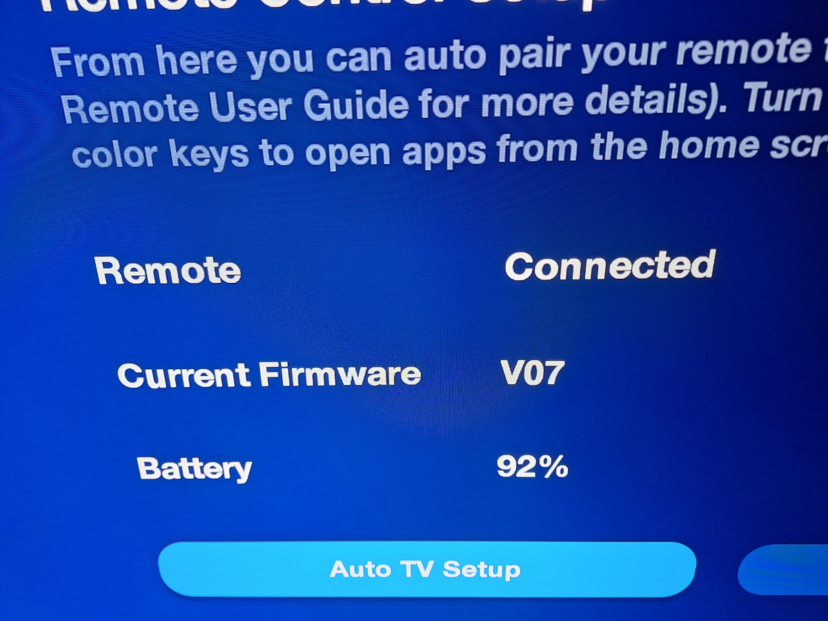

The U5, comes with the BT300/400 remote, so only 1 set.

What I mean it's to have the menu Power off / Restart
Yes the power button puts the TV and the box in standby. So HDMI-CEC it's properly configured.
But if I want to unplug my box from power outlet, I should first Power off, not put the box in standby
But when HDMI-CEC is enabled AND Auto TV setup configured it's not possible to acces to the menu Power off / Restart. Only standby
When HDMI-CEC is enabled AND Auto TV setup NOT configured I have three choices for my box : Standby (with power button) and Power off / Restart with the menu
When HDMI-CEC is enabled AND Auto TV setup configured I have one choice for my box : Standby (with power button). Power off/Restart menu (long pressing power button does not display anymore Power off/Restar menu, puts everything in standby).
It would be really nice to have HDMI-CEC enabled AND Auto TV setup configured AND long pressing power button makes the Power off/Restart menu appears

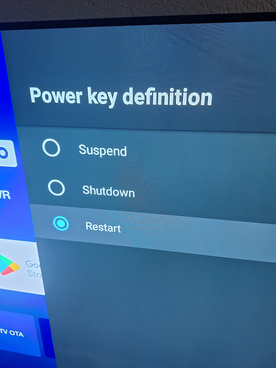

11 minutes ago, dishuser said:
change powerkey option
it does not work, it puts the TV in standby mode and nothing happens to U5 box.
And even if it's works it's not a good option. Imagine, I reboot my box but my TV is in standby mode, and I should power up again my TV.
The mistake and the Auto TV setup is "will control Power" Auto TV setup should only control the Volume of TV not the power (standby).
HDMI-CEC it's here to control the power off ot TV.
I am really the only one I see it's an non sense ? I don't think I am so stupid and crazy, because on all other boxes the equivalent of Auto TV setup does not control the Power of TV only volume.
50 minutes ago, ismael said:
It puts the TV and the U5 in Standby (HDMI-CEC is enabled AND Auto TV setup configured). No more menu with Power off / Restard options
This is because it changes the power button and vol buttons to IR to control the TV directly
Not the box. And since we only have one power button on the remote. That's how it works
We have a new remote coming out. The BT500. Which resolves both issues as it will have 2 Power buttons (TV + STB) and 2 Vol +/- buttons ( TV + STB)
