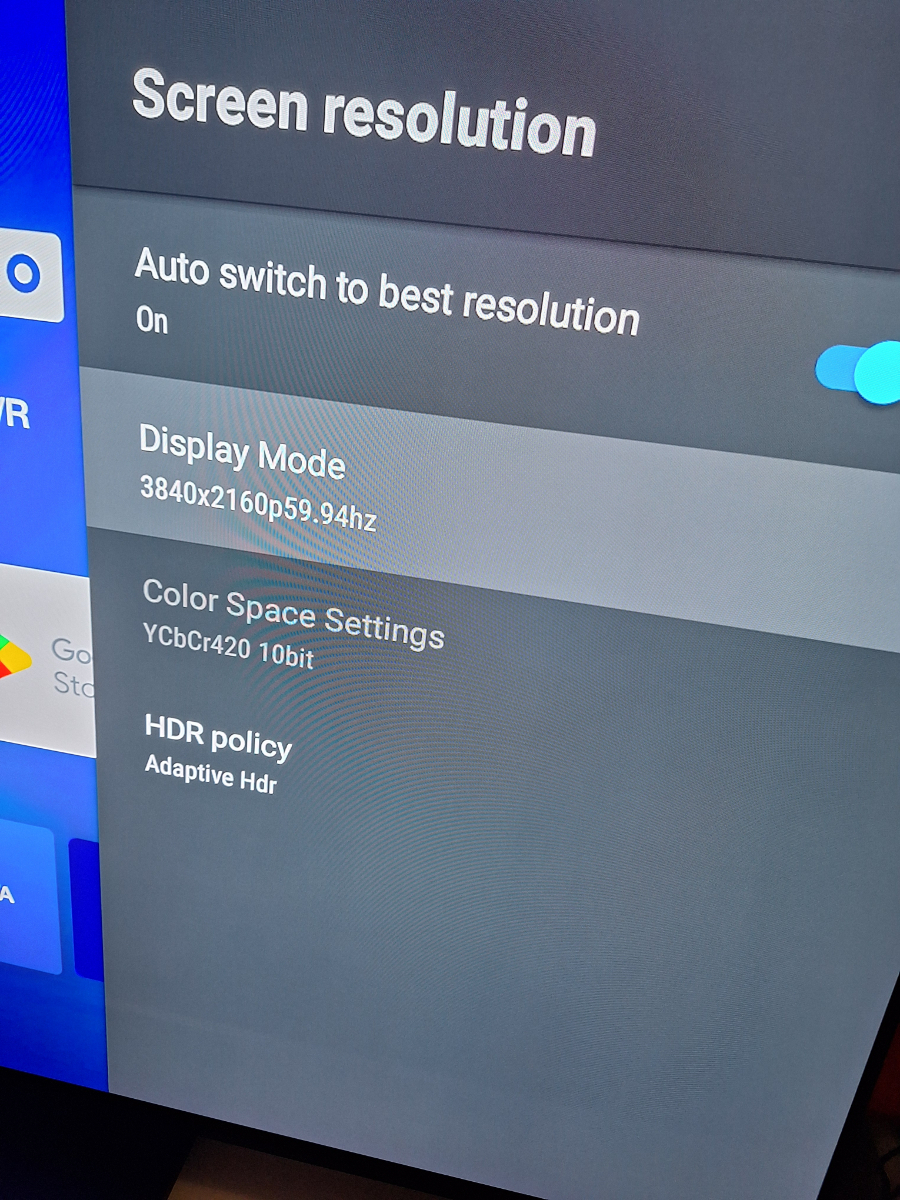

U5 color space setting
I can not change the color space setting it's greyed. It's stucked on YCbCr420.
Not a problem from my TV, because on the others devices I can change this option.
Could you please fix it on next release ?

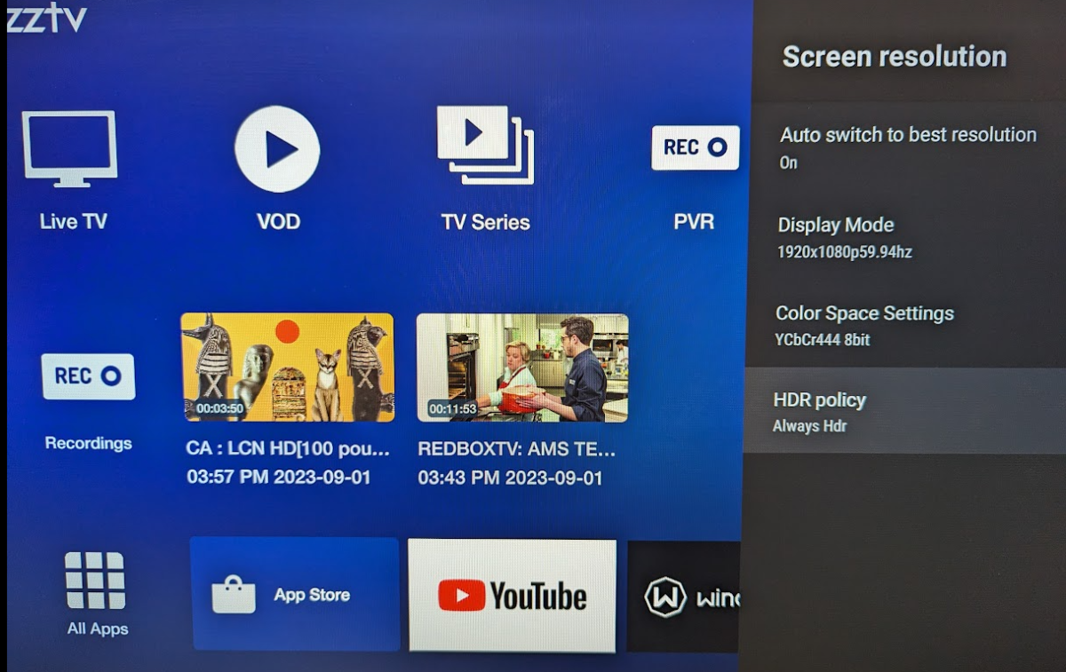

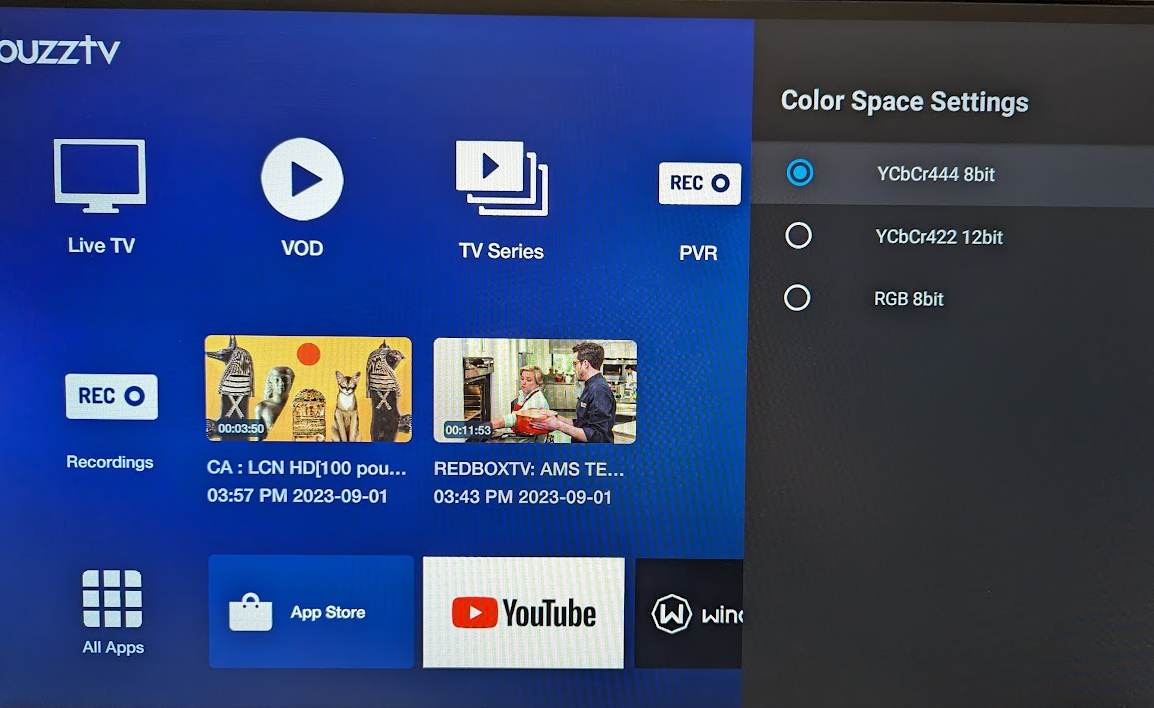

Yes I consider that the box requiers a fix/update, because I tried a lot of boxes from other brand and with all others brands I can change this setting it's not greyed.
Here attached the picture of U5 (setting greyed) and picture from other box (free choice of settings)
Both boxes were on HDMI 1 port, with the same HDMI cable.

These settings where available with : Formuler Z11 Pro Max BT1, Amiko A11 Gold, Amazon Fire TV Stick 4K Max (2. Gen), Xiaomi TV Box S 4K (2nd. Gen) and others ...

Colorspace is grayed out when a TV is Dolby vision, also grays out if resolution set only supports certain spaces
Not really a bug is intentionally coded that way by amlogic this way
We could make it so it never greys out but then a person could potentially set a unsupported res/colorspace combo for their tv
Hopefully this answers your issue

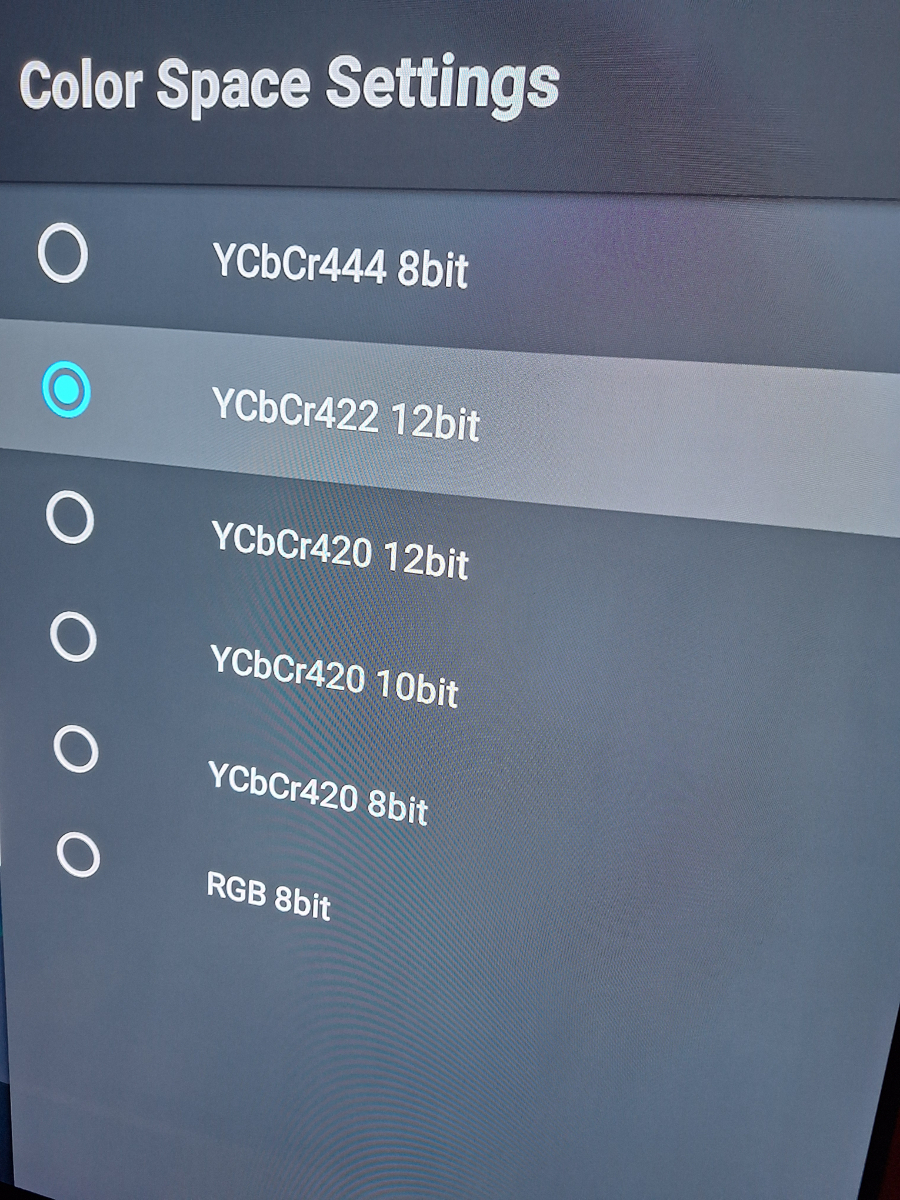

I have other device with amlogic S905X4 and I can change this option.
Personnaly I watch with YCbCr444 8bit or YCbCr422 12bit, because my TV can support it. Because it's the best option for colors. As technical guy you know why.
