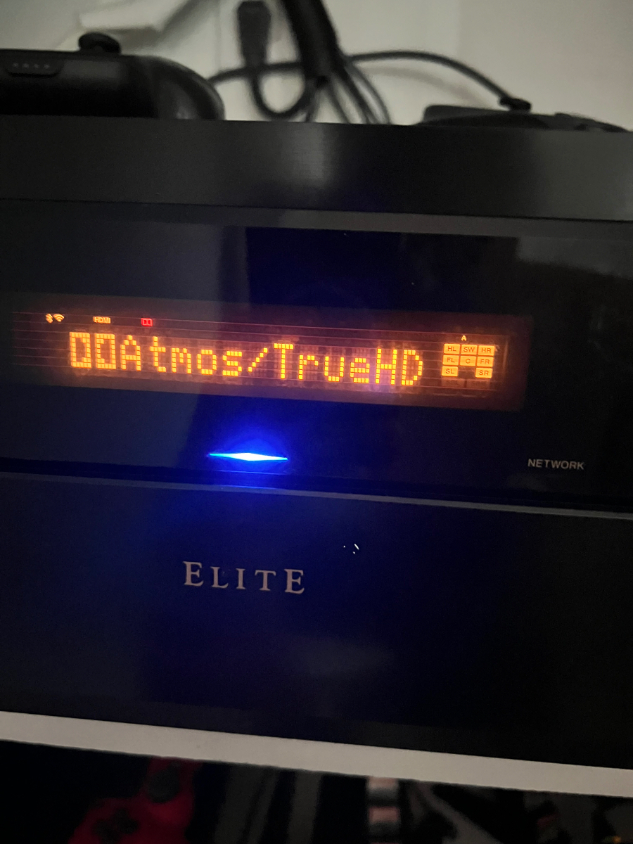

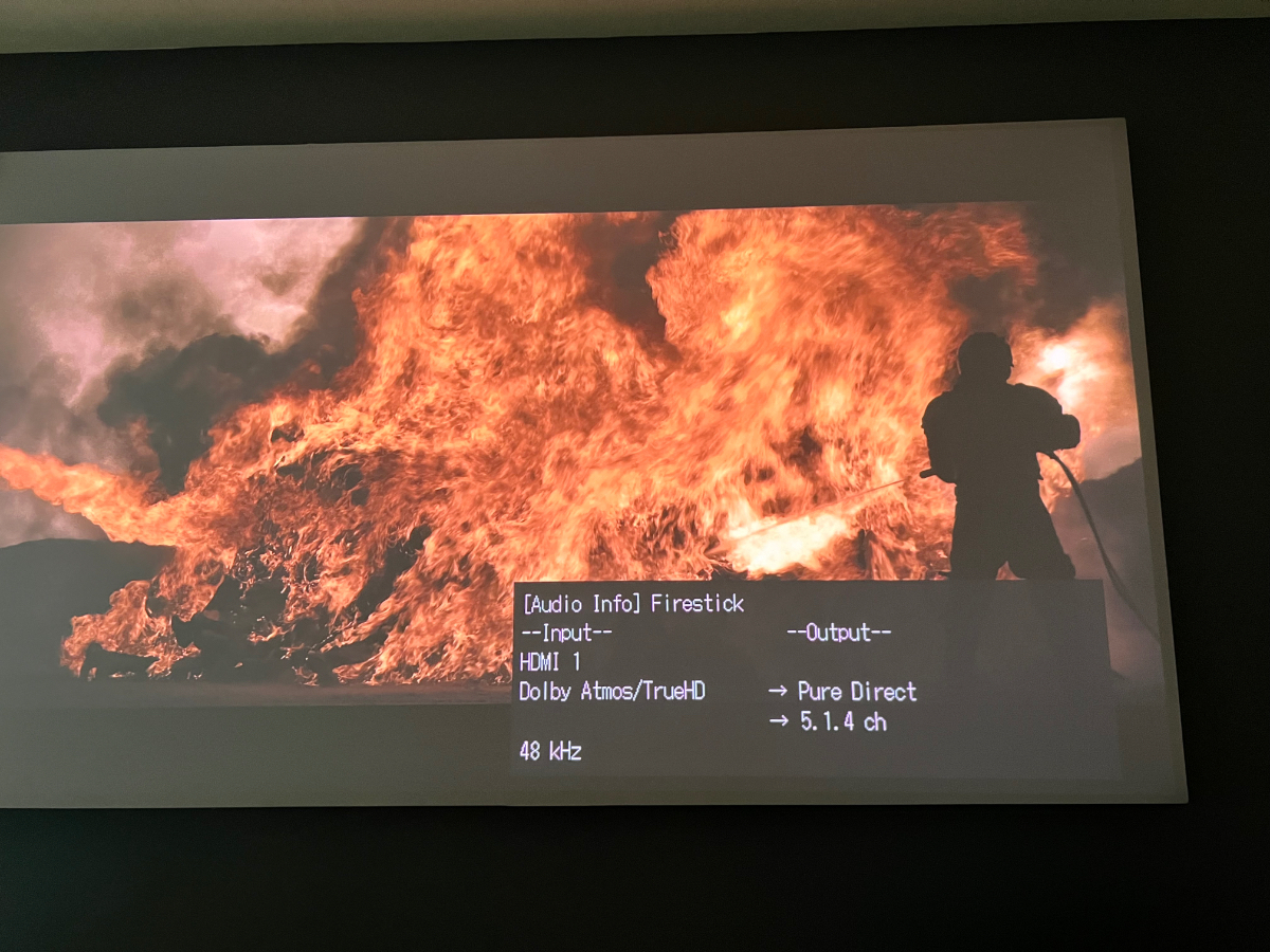

Hey group. New to forum, but have been lurking for awhile. Running hdmi to everything and also running the fire cube 3rd gen. I have kodi running on both. Set things up on kodi and have the box sending audio through hdmi to my amp (same as the cube). The 4900 will play the dd+ Atmos fine. Truehd however is not passing through (settings are set correct on kodi). My amp reads 2 channel pcm. Is there a setting somewhere to enable pass through?  In the audio settings I have set it to manual and turned on all formats. Trying to compare apples to apples to see if I even need the cube.

Well. Switched out cube for buzz. Tried buzz with settings set for both Plex and kodi. Nothing but pcm 2.0 with all my truehd files. Dts and dd+ Atmos both work and switch over on amp, but notta for truehd. Keep all the cables the way they are and switch back to cube and all works. Nearest I can see is it is not letting truehd pass through.

Thank you for the response.  The fire cube and shield both pass through truehd. Just for knowledge. I do appreciate the response.
