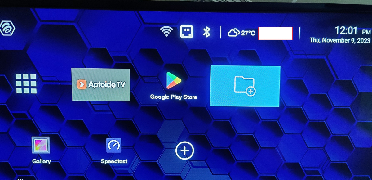

Can't find the settings button anymore
After I changed the home screen I used the media player I can't find the settings button anymore to revert to the original
I tried everything I can't find it.  I read somewhere that on google you move to the right of the screen and it moves like a page
but it's not all it does is open up chrome
I have aptoide, google play store and a folder with a plus sign and clicked ump times on the right arrow as well as the top 2 right arrows for the recordings to no avail at the bottom I have a couple of apps I installed like speed test and gallery and a plus sign I did the same thing and nope the settings button doesn't appear
I just tried and see it has changed
press the up arrow to get to top toolbar where settings tab is
We can't be on the same page because what I have on top is a grey wifi, the ethernet because it is connected to the ethernet the bluetooth logo beside I have the temperature of my vpn connection location and the time and date beside it on the right.  I moved the arrow to that position on top with the mouse arrow and than click and nothing appears.  We are talking about an E1 not an X5 that's why I posted here.  On my X5 I can see it on top but not the E1
This is what I have on my tvIMG_20231109_120128.thumb.jpg.0cea4d83f0a6feb17da8bc8e3506c002.jpg
Edited by LINDA B
I don't have my E1 in front of me, but it I recall (from memory), it you select the first icon (the 9 small squares) it will open the all apps screen.  There I do believe there is a settings options.  From the settings screen you should have something in regards to the "Home screen" to be able to change it.
I was sick and tired of screwing the dog with this box I did a hard reset but the downfall of this box there is no backup so I had to spend 1/2 a day again to re-add all my favorite channels in the order I want
Did you check my last comment to go into all apps and look for the "Settings" icon app which typically allows you to change the home screen settings ?
