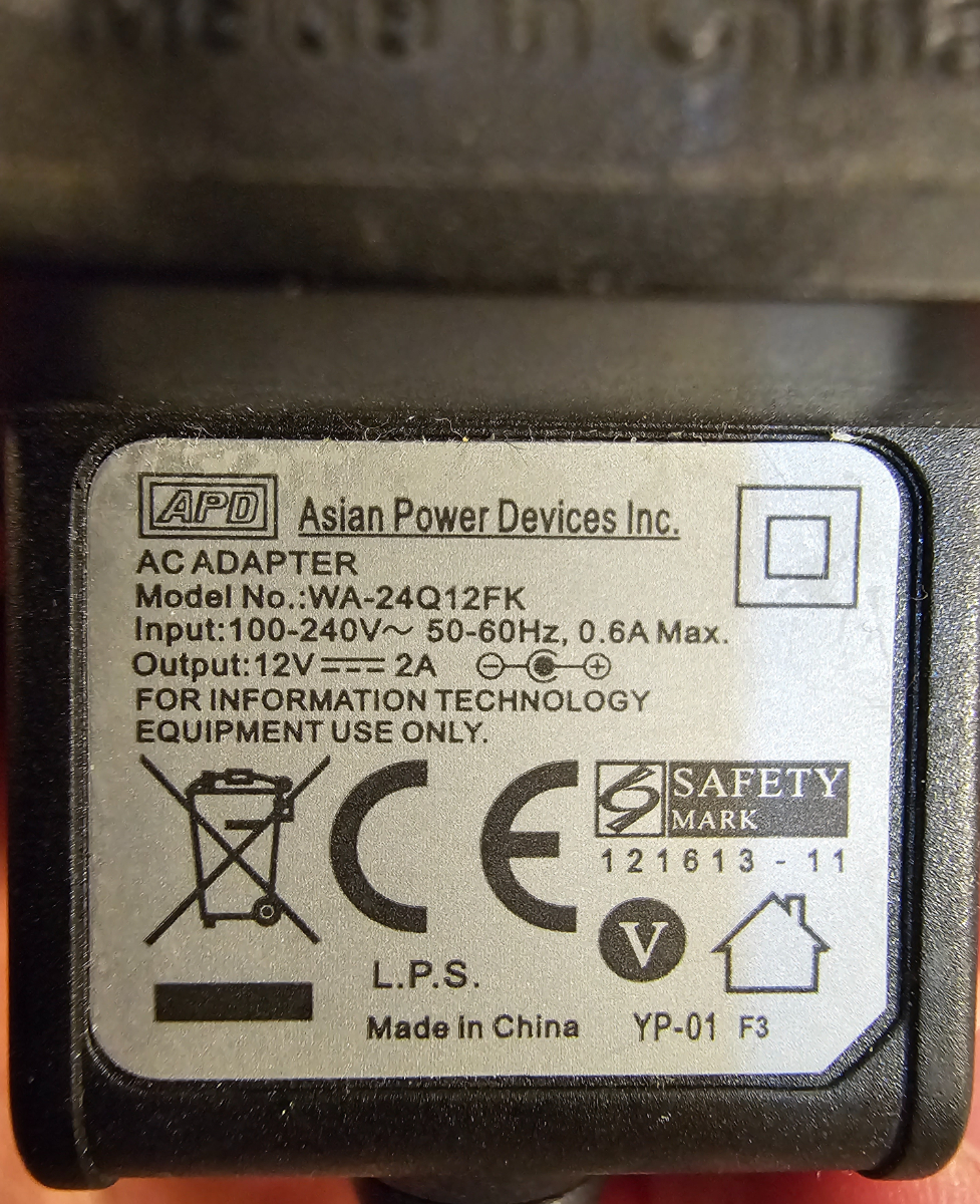

- Tried an alternate power supply rated at 12v 2a.

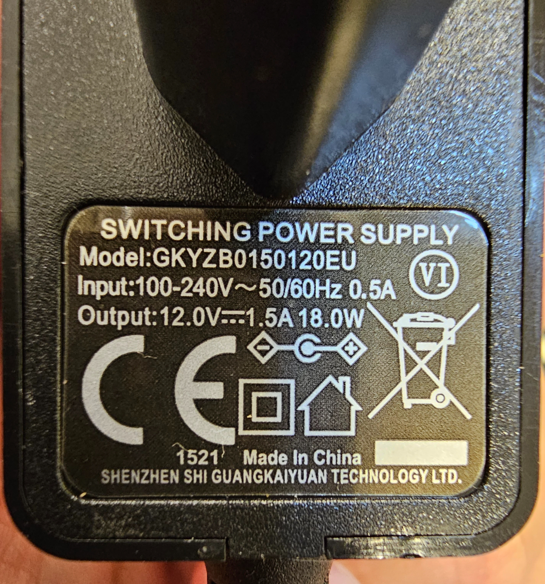

why 2Amps? it needs 1.5A. did you check your junk emails? reply to that email again

@Ryu I used a 2amp power supply because that's what I had lying around. I was trying to rule out the OEM power supply as possible source of the problems. AFAIK, using a higher amp rating should be a problem. I checked my junk folder, nothing there and sent a follow up email as you suggested.

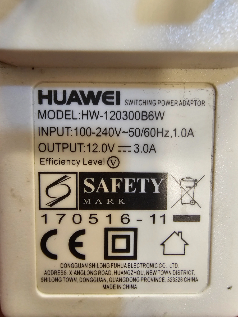

Just curious, I have to ask, since many have made the mistake.  You are actually using the power supply that came with your U5, and not a power supply from a previous Buzz box ?  Reason I ask, is because the U5 uses a 12V power supply, which most others (except the xrs4900) all use a 5V power supply.  The U5 will power up, and seem to work with the 5V power supply, but can be unstable.  You need to use the 12V one that came with the U5.

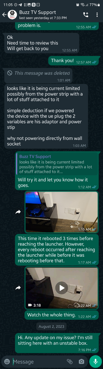

Unfortunately I don't have anything positive to report on this. I still have what seems to be a defective box and zero support from BuzzTV. I was able to get through to support on WhatsApp. After a lot of troubleshooting, changing of power supplies, power outlets and sharing of video recordings of the problem, I was told they need time to review and would get back to me. That was on July 25. I followed up on August 2 and my message was read but was not responded to. My original ticket #20217 from 11 July is still open and unresolved.
At this point I've accepted my losses and given up on expectations of any kind of customer support. Lesson learned, don't buy BuzzTV.

Yes I am. I have tested the box with 3 different 12v power supplies with no change in behavior.

The 3 power adapters are the only ones I have tried. One of them is what I got from buzz which is the EU version rated for 100v to 240v and 50-60Hz.

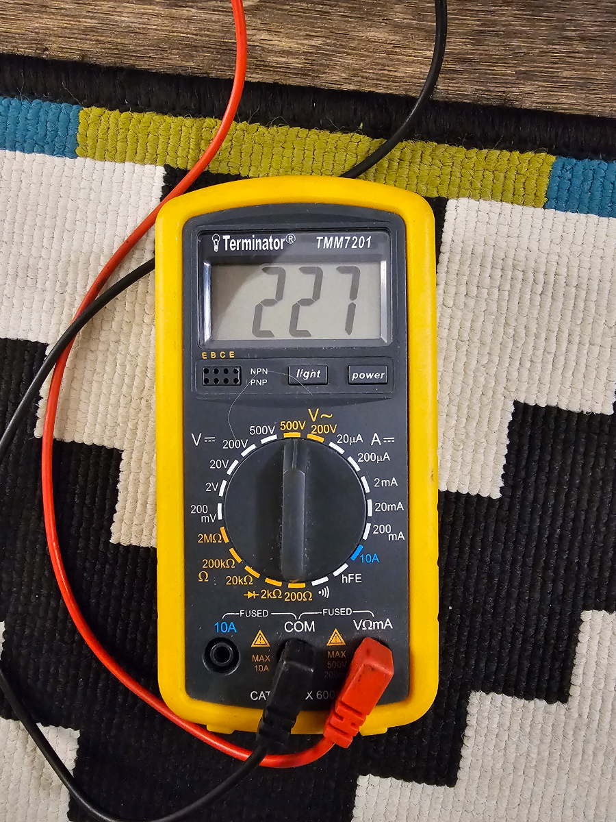

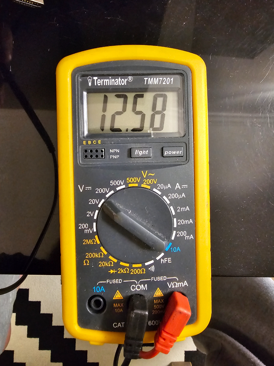

No, I don't have anything like that on hand. However I would suspect if the electrical system at my place was improper I would see other devices malfunctioning or getting damaged. Apart from the typical household appliances, I have the usual battery of electronics at my place, a router, a modem, several wifi access points, PCs, laptops, TVs, TV boxes etc. Never had a problem with anything. The U5 is the only thing misbehaving.
I was able to test the voltage on the outlets and the power supply, both of which check out. 227v and 12.58v respectively.
I also tested the U5 with a different TV, in another room using a different outlet, (replacing a working 12v Android box) with no change in behavior. Still goes into a bootloop.
Actually the U5 doesn't even have to be connected to a TV, you can tell it's in a bootloop looking at the indicator light on the front. Goes red after after 30 or so seconds. It does eventually boots to the launcher but then will reboot again after a random period of time.
