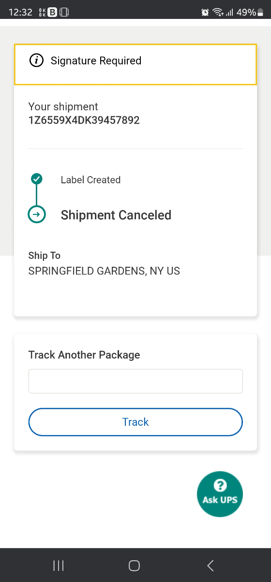

  4. Saif Barry replied to Saif Barry's topic in U5
    @allaboutbuzz power supply shipment canceled. Not sure why, trying to follow up with support to find out what happened.
