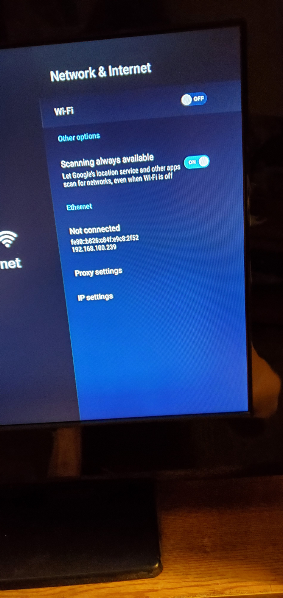

So I have noticed a few things first thing is when I go into the settings and into Network
in there it says that the Ethernet is not connected but it is. So why isn't the box detecting
that the Ethernet is plugged in because it is.  This connection is wired and has an Ethernet
cable plugged into which goes directly to my router Which is maybe 15 feet at most away
using I believe a cat 6 cable.
When a Network cable is plugged in the Buzz TV XR 4000 box should detect it but it isn't but
I still have full connectivity. It is set up to pull an IP from DHCP which the box has done
as you can see in the picture that I attached.

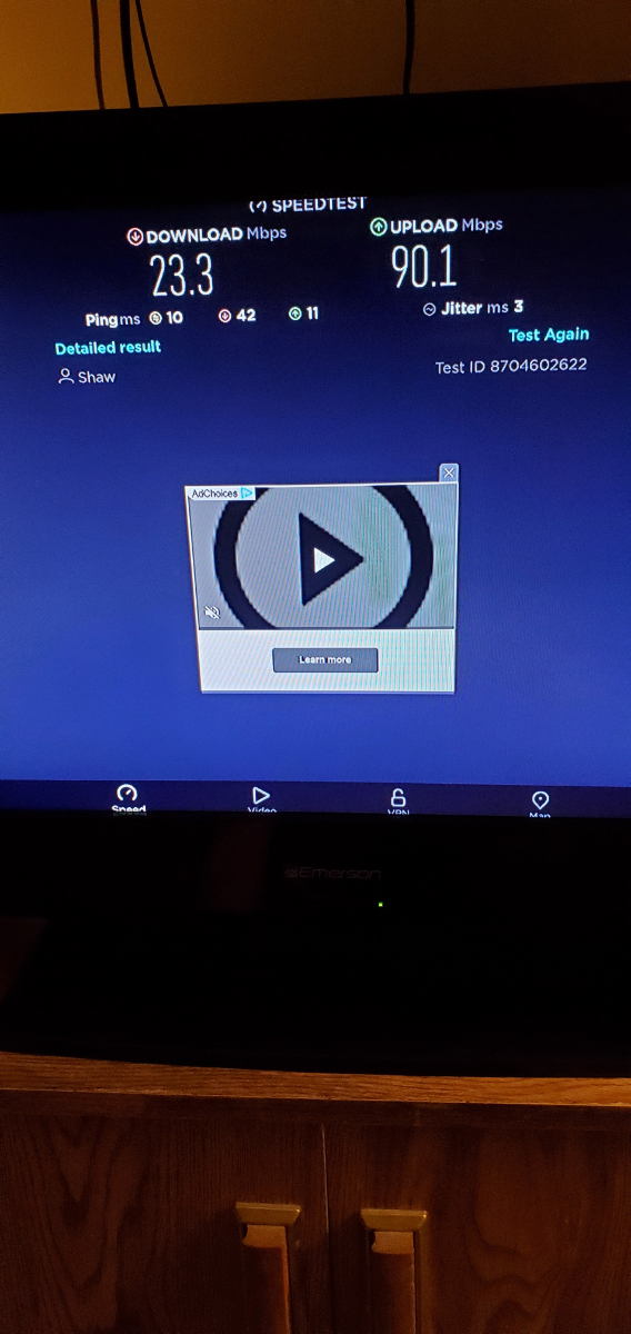

The 2nd issue I am noticing is wow some very slow speeds coiming from my
Buzz TV XR 4000. Now I am on a very fast connection a Gig-bit connection
My connection caps out at 1000 Mbps now when I run a speed test on the box
using an app that I put on there the speeds are horrible for it being a wired connection
I was getting 23.3 Mbps Down and 90.1 Mbps up.
Now in comparison when I run the same test on my laptop which is also wired
using a network cable I get the following speeds on my laptop.
I was getting 902.59 Mbps Down and 107.17 Mbps up when I ran the same test on the same
network That is much better. So why is the Buzz TV XR 4000 box getting such bad speeds
my network can clearly handle more and it isn't coming close to capping out my network.
https://www.speedtest.net/result/c/e675c1b7-cb94-4a34-a623-c6a993c6fcdf

OK.. The connected vs not connected status message is a bug on many Android 9 boxes (and not only buzz boxes).  It does not affect connectivity (and you do see the IP address), but it is annoying.   In some cases, just toggling the WiFi button on the top ON-OFF again, will force change the status message.  This is not isolated to just the xr4000.

And the connected issue IS still a bug it isn't detecting the connection right and it still
needs to be fixed

Also toggling Wifi off and on didn't work still says disconnected. Even after me doing that I tried
that after you mentioned that.
I opened up the most recent version of Google Chrome on the the Buzz TV XR 4000
and the speeds are the not that far off from before.  speedtest.net is Ookla and they are known to be good which
is what I was using before.
When I went to https://fast.com/ I got the following for a speed
It it says Your Internet Speed is 30 Mbps
LOL nope not even close My speed is closer to 1 Gbps and I have pulled 700 to 900 Mpps
on this connection.
To compare when I went to that same site on my laptop it said my Speed was 1.3 Gbps

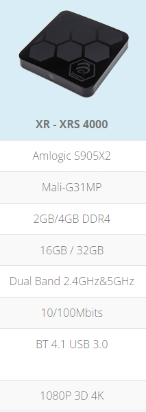

Genius doesn't know the limitation is on the BuzzTV box (10/100) Ethernet port.
Here's the Screenshot of the specs (below). No wonder he is still working an Admin job.
BuzzTV trys to upscale content to 4K killing the buffer on that old school 10/100 Ethernet.
Seems like now time to upgrade my Buzz to XRS or X5 model
Edited by Poison Aid
XR4000 specs image attachment

There is nothing to fix on our side. Issue is on your side. The Ethernet port speed on the 4000s work fine.
