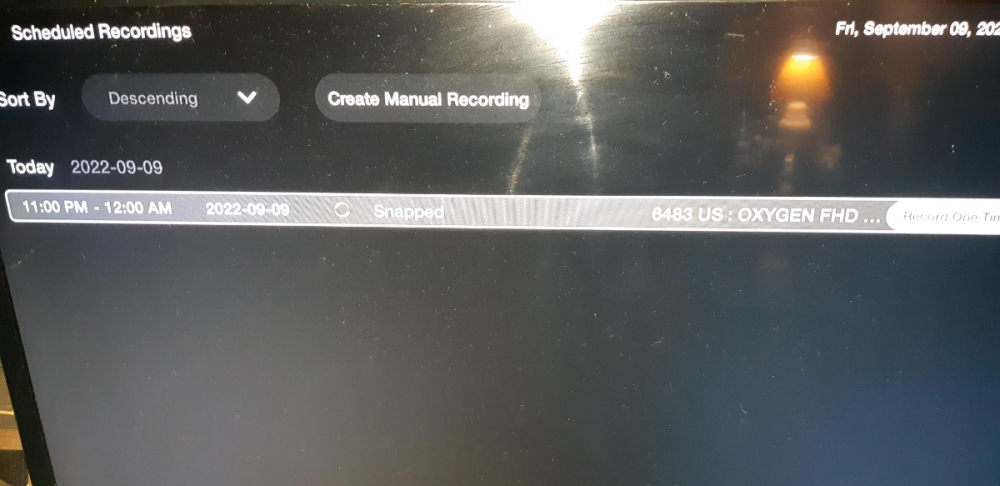

27 minutes ago, Terry Knapper said:
So , if I am recording a show, say, Fri from 11PM until 12 midnight, and I want
to extend the recording by 5 min then I have to set up a 2nd scheduled recording
from Fri at mid until the following Sat at 5 min after midnight.
Does that sound about right?
How did you setup this recording?
Manual Scheduling or through the EPG?
If Manual, just setup the Start and End Times yourself
If through EPG
2 ways
1.
Press Menu
PVR
PVR Options
Extra Recording Time, set how many minutes you want all recordings to make to have time added to the end time.
2.
Press Menu
PVR
Scheduled Recordings
Highlight the Recording you want to edit
Press the yellow button to edit it
You can change the end time on here and save it.

You are right. Actually you HAVE to change the end time if the end time is 0000;
you HAVE to either add or subtract time, the scheduled recording will not allow a time of 0000.

it allows that time if you change the date like I said earlier
if you do it from epg it shows 12:00 am and next day
