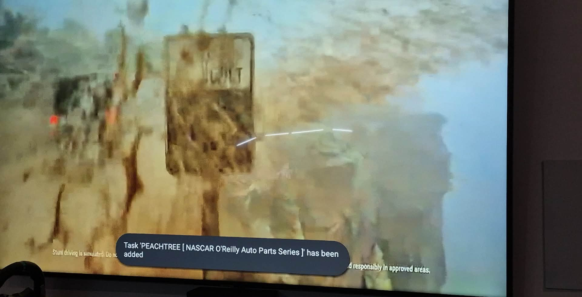

I dont record much, but later today I want to. I select the channel, and put the show on, hit the red button and a grey message appears Task 'CHANNEL' [SHOW] has been added

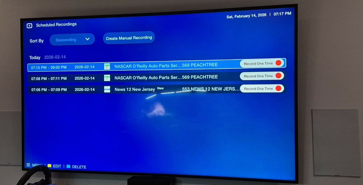

it shows up in my scheduled menu under PVR, but not recordings.  I have tried setting a manual recording as well, nothing happens.

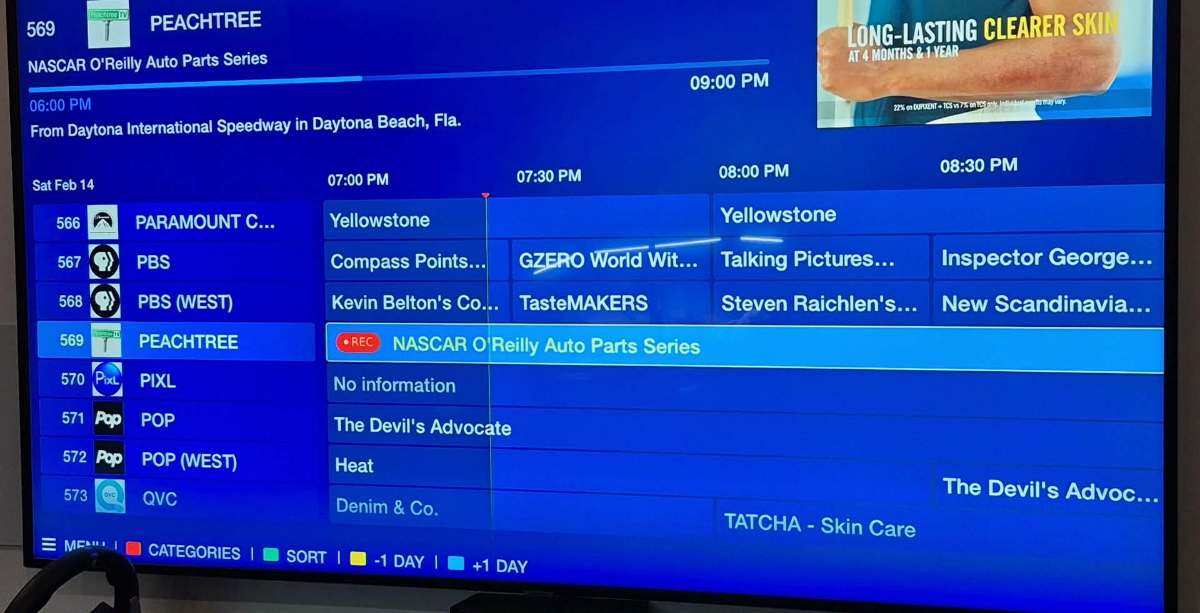

A red symbol shows up in the guide that I am recording- I think?

OK, so I found one button record was on, turned that off now I get the recording settings menu pop up.  however, when i save, it still just generates a task, doesnt start recording

So I have tried that, and a red record icon does not show up. *** IT SAYS REC ON THE GUIDE BUT NOT AT THE TOP RIGHT CORNER if I press the red button (i have confirmed the red button is still set up default and not reassigned to anything else)
I have pressed the red button, with One button record active, and it displays the grey banner above about adding a task.
with One button record disabled, it opens the recording settings menu, and I save it but it reacts the same, sets a task but no recording.
**this is with current live shows, as well as set up a future recording and still no recorded shows in the PVR menu.  Just tasks

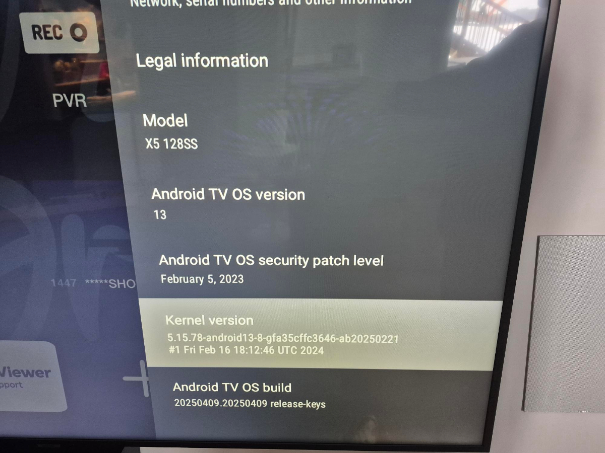

8 minutes ago, nbs. said:
Hit menu button on remote and post what version is at bottom
VERSION 5.0.947, UPDATED 01/10/2025
