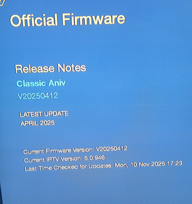

My buddy already had a few buzz boxes and last one he got was was a Buzz Classic.  He asked me which one I would recommend this time around (since we wants to retire his old xpl3000 - which had a good run - and still runs), so I recommended the new Buzz Classic Anniversary edition, since he already like his original Buzz Classic.
Well he got it this morning and decided to start configuring it.  I guided him through backing up his servers/favorites from his original Classic and restoring on his new box and all went smooth.
However, when he tried to launch youtube, he got the same message another user was getting on his B5 recently.
Youtube is not supported on this device.
Asked him to check the firmware and software version running on his box, and he has V20250412 with 5.0.946 (not that this portion makes a diff for this case):
And for Youtube version, he has 3.01.005 (which happens to be the same as on my mom's B5 I checked this weekend):
Even though my mom's B5 has the same version and works well, I also checked my original Buzz Classic at home and I have youtube (com.google.android.youtube.tv) version  5.30.304 on my original Classic.
I don't have the Classic "Anniversary edition", even though I recommend it always to friends, but would someone who has an Anniversary edition please check the above version numbers and tell me if yours match ?  And if Youtube works ?
I have told him to try a factory reset (since it is brand new and has not done any customizing on it yet), but just curious what versions others are running, and if it works.

I just received a Anniversary Edition and experiencing same issue.  The app is a locked app and cannot be un-installed because device isnt Rooted or able to be rooted.  The Aptoide version is NOT really YouTube , nor is it google certified , nor is it safe.  It's a fake version used in China.  It sure would be nice if Buzz Team would fix this ASAP as YouTube is kinda essential.  Hoping someone from the Dev Team can comment or update folks on this issue.  I hate doing Amazon Returns.

It is not possible to Uninstall the YouTube app , there is no un install option on the affected devices.  You also cannot revert updates.
there are no options but to Force Stop and Clear Data/Cache.
How much longer before we can you use the YouTube app on these boxes ??
On Aptoide, the one you want is not just "Youtube" (from Google Inc), that one is more for phones.  The one you want is labeled as "Youtube for Android TV", and the versions all match, and you should have the option to "update" not "install".    Since the internal name will match the com.google.youtube.android.tv as shown above.

Was fixed on E5s and X5s this week via FW update
Will be rolled out to the rest of our Android 11 models next week, including the Classic and Classic Anniv

B5 and U5s should get it tomorrow
HD5s next week, and that will be our entire Android 11 lineup
