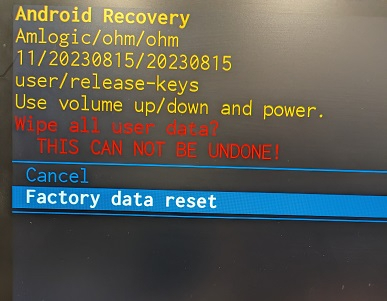

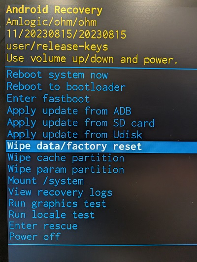

So when you go through the pinhole, you get this screen first...
And then after selecting the highlighted option, you get the next confirmation screen ?
And you select that and then see the box formatting partition, etc.. Before coming back and highlighting the reboot now ?
At the second confirmation screen, I "tried" to hit the back button on my remote to NOT do a reset, and I found out the hard way, that I should have highlited the "cancel" option instead, since the back key just confirmed my factory reset 🙂   Oh well.  After that, since I had gone this far, I decided to choose the 2 other options" wipe cache partition" and "wipe param partition" and only then did I reboot.   Don't think the last 2 are needed (since the first option does it all.
Anyhow, after  reboot, the box asked me to pair my remote, select my region, connect to internet, etc....  Once that was done, a few seconds later it started to auto install some of the basic apps (vlc, disney, netflix, etc..)..  Once that was done, I checked my server settings and they were all blank :).   No big deal, since I have them all saved on a USB stick, put it in and restored them.   Few seconds after launching my Live TV, the box decided to take a new update.
And this is all on the EXACT same box you have (the X5 128AI).

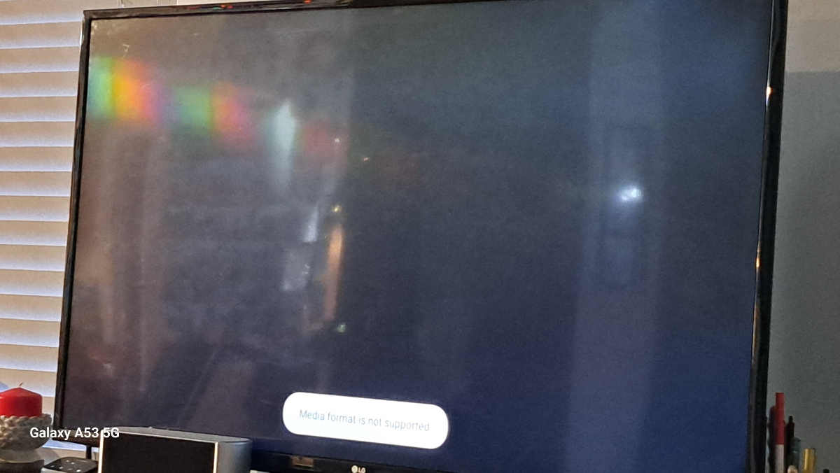

Well bad news, was to good to be true. I had to finish my movie with my cellular.
The message I get and even went watching a channel. There is the message. I also included a picture of the message.
(Media format is not supported)
Edited by Gilles1945
Can't see my picture
Sounds like the server either stopped streaming for a while OR Changed stream and/or stream format on the fly.
Are you using MAC, XC or M3U type server login ?
If you are using XC, I would recommend changing the stream format.  In the Menu -> Settings -> Configuration, it is now the 7th option from the top.  You should have "Automatic", "M3U/HLS" or "TS".   Possibly the Automatic may not be working well with your service.  Try forcing it to "M3U/HLS" or "TS".  If that doesn't work, try the other one.
