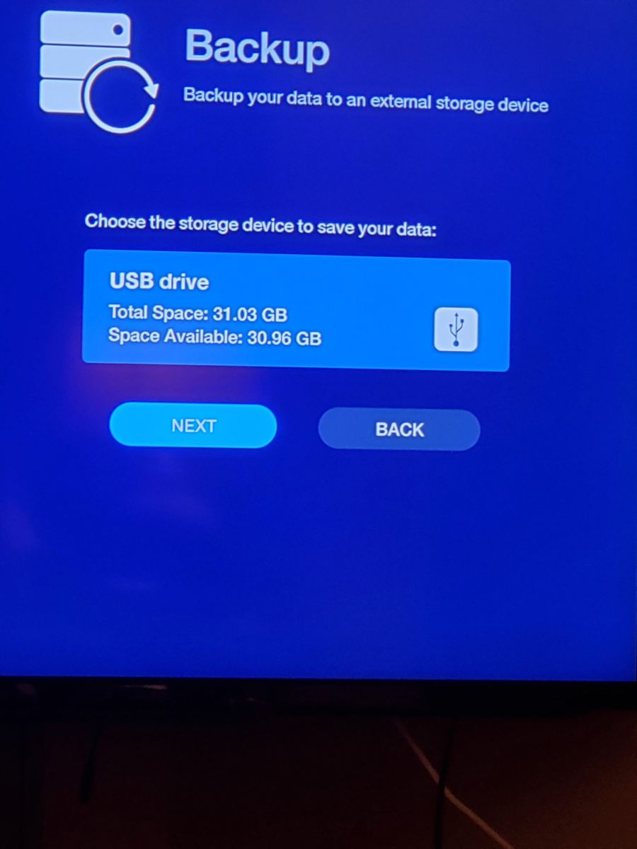

dish it comes up on mine.. shows me to back up to usb
restore only not backup
you get no choice on backup so it goes to internal automatically

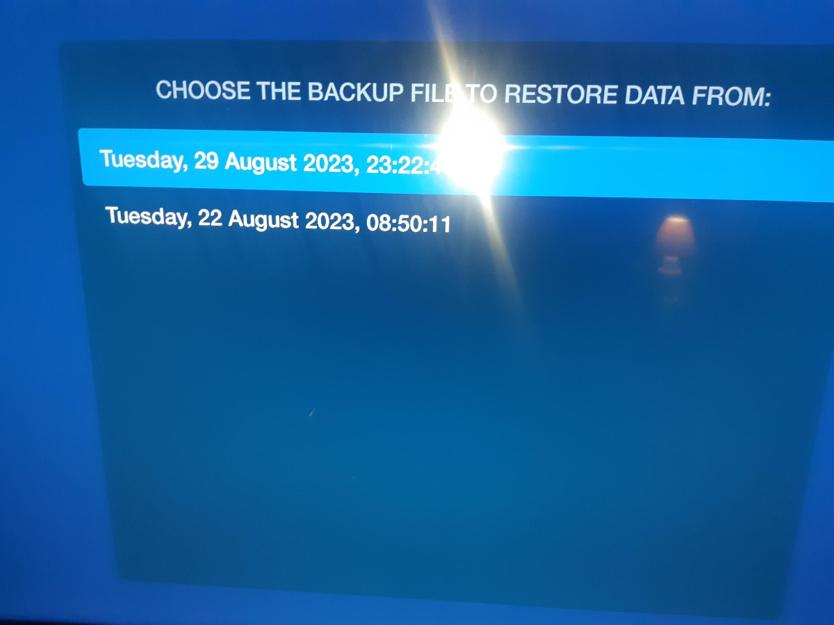

if you want I can post a video from the 5 series that gives you a choice
the diffence is OS
but I have a backup from my x5 and my 4900 on same stick and I can use either on both devices since it's only backing up settings,servers,favourites and favourite groups

If u notice it says back up on screen not restore
and if you notice after you do a backup it opens the download folder on the internal drive
Actually it does not but i managed to backup data on intrrnal storage and when i go to move it to sd catd or usb it saus it cannot writte data so again not working for me

the one on top is from my 4900 and the other is from my x5

I just tried on my 4500 (should be same as 4900) and had no issue doing backup onto USB stick.  It was a little strange however, since during the process it did ask if I wanted to go to internal or external USB, and by default external was selected (like the screen Woody has posted above).  But then when I hit next and brought up the little file manager to select where to save, it was by default on internal storage (even though external was selected in previous step).   But quick selection of external and hit next and it did go to usb stick.  But if you do not realize it, I can see how someone can accidently do a backup and "assume" it was done to USB even though it was internal location selected.
I removed the stick and went to restore option and nothing was there (which is what I expected).  Then I inserted the USB stick and it showed the backup I just made.  Also, checked stick on my PC and the file was there.
