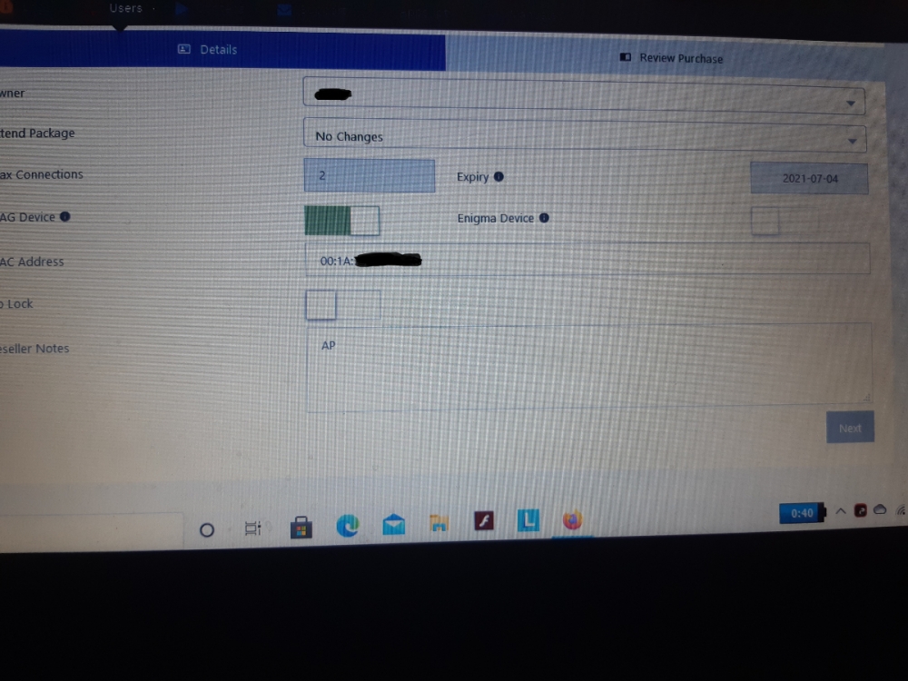

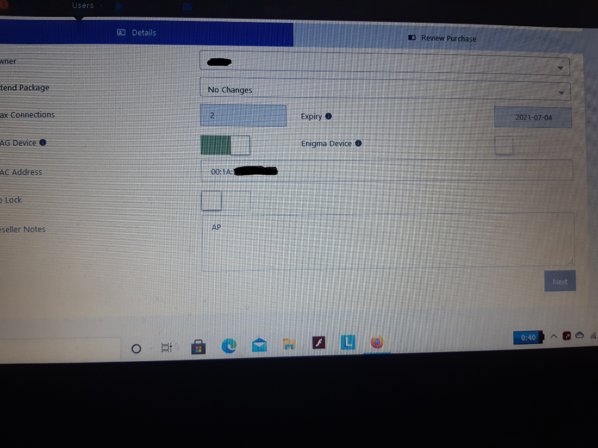

I have a mac server that allows 2 connections
19 hours ago, allaboutbuzz said:
The Buzz 5 app has a way to detect if the server you're using supports record + watch another
This only works on XC Login + M3U Servers
MAC servers is not possible to offer record + watch another, as they only allow 1 stream per subscribed MAC.
Thanks for letting me know, this is great information!
