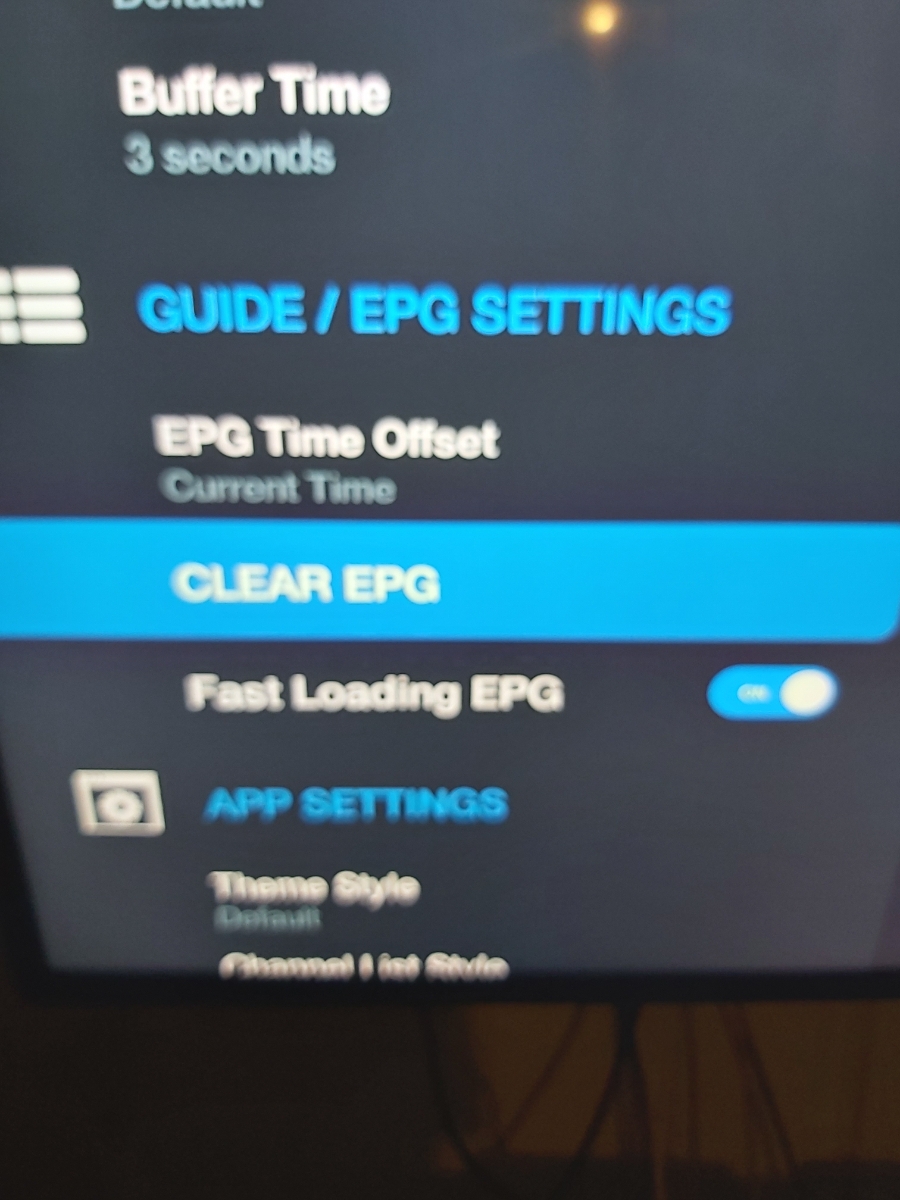

Been there.  Under guide/epg settings all I have is :
epg time offset
clear epg.
No fast load option.
Cleared epg still takes the same time.  Cleared cache
No joy.
Do not have that
Fast Loading EPG  on off choice.  pictured
Thanks for the picture.
