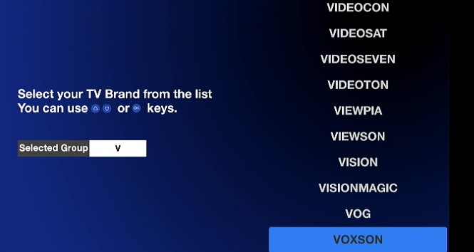

Next I did the factory rest of the BT400 again but this time I tried the manual setup .... there is no code list for any Vizio TV in the TV list. (see attached)

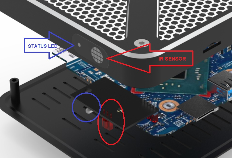

Where is the IR sensor on the X5 128 ai?
on the front of the box obviously
It's right next to the status LED.

There is still an IR sensor on the front of the box as pointed out in the post above mine
