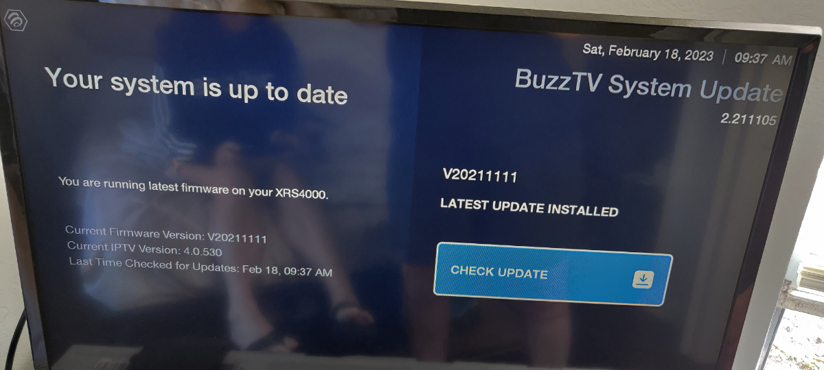

XRS4000 2 yrs old and still on version 211111. I'm having wifi connection problems. Box keeps dropping connection and having to restart, disconnect wifi, only for it to continue all over again. All devices in house do not drop and receive full speed. I do not have access to ethernet right now. This box isn't that old to have these issues.  Suggestions please and FAST!!!
9 minutes ago, Light House said:
Version number is in the thread
It's not in the thread but it's in the pic you just posted

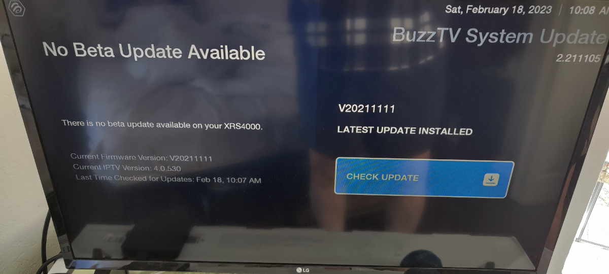

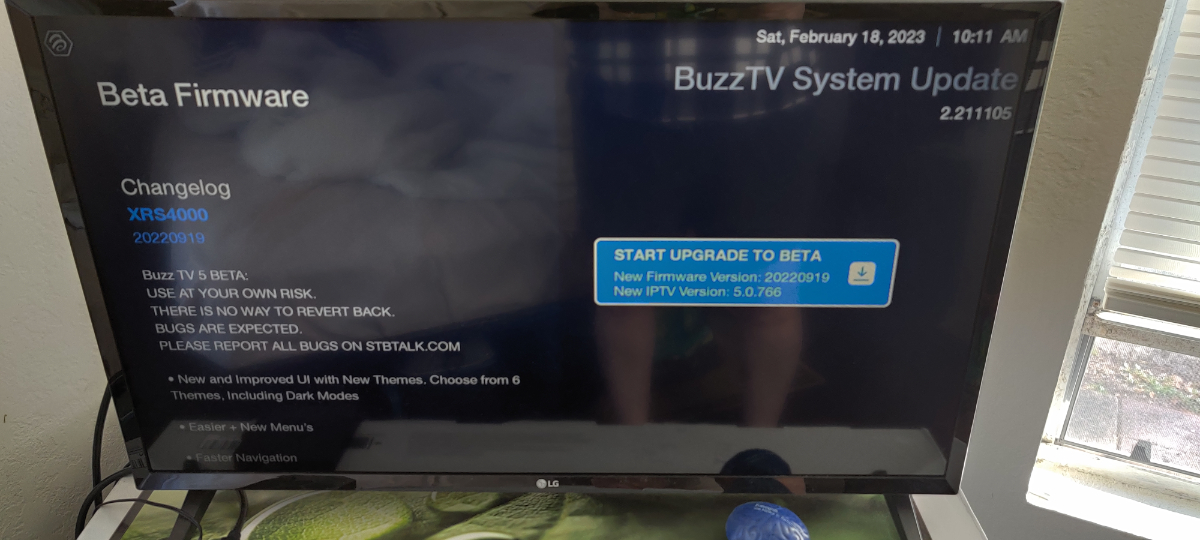

After checking for update enter 2015 on your remote
This should update you to buzz 5 software
Your firmware is up to date
Issues can be fixed in software updates too It doesn't have to be firmware

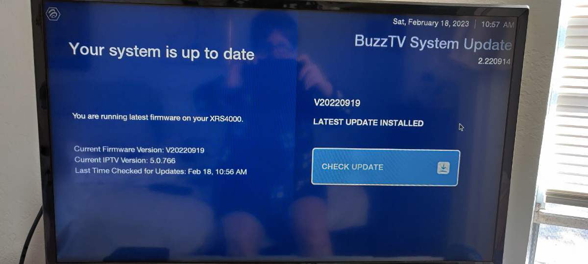

Okay I see that you can't revert back to old version if you incur issues . How long has this Beta  version been out and what am I getting myself into as far as Bugs?
