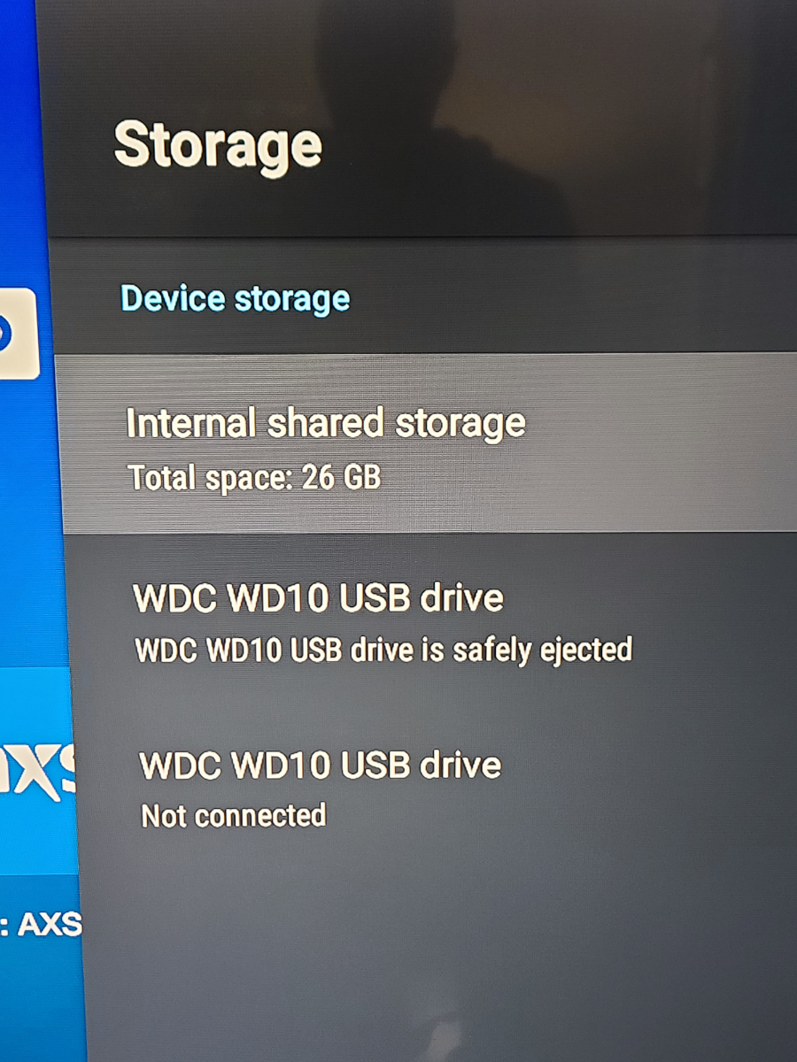

Hi. Thank you for the feedback. I have done so to no avail. I’ve replaced the HDD with another HDD to discard the possibility of a defective HDD. NOT! Weird thing is, once I formatted the new drive (multiple times), I could not transfer data to it. After that, a new “Android” drive shows under “Storage”, and after several attempts to do so, I now see several identical HDDs listed, besides the original one, but all say “Disconnected”.
What gives? I think the BIOS needs rework. This is so disappointing!
I see 2 usb's not connected and 3 others listed that are connected (only have 3)
how did you format drive and what did you select?
Hi. I formatted the new drive  using the same default option for storage and something else (I forget the wording). Next, I tried storing my device data (apps and stuff) on it and this is where it supposedly failed, prompting me to repeat the procedure, only to discover that the drive still does not work and now I see it listed multiple times without an option to remove or “connect” a disconnected drive.
On the repeat occasions the formatting appeared to be functioning (progress bar) but others it would simply and immediately display a message saying “formatting completed”.

The two drives are WD HDDs, 1TB capacity; one the original that came with the “Launch” promo and the other I had laying around from another PC.
eject the drive
unplug and plug back in
and format as removable drive
don't forget to go into pvr options and select that drive for what you want
mine is listed as android in both my u5 and 4900
As DU mentioned, if you have an option, you NEED to ensure it is formatted as Portable Storage and NOT Internal Storage.
Thank you for the feedback. I’ve done the first several times when it’s detected. The other times I can only see its status.
I’ve disconnected the device, turned power off and restarted it. Sometimes I would see the message about the HDD being attached, but only 2 out of 10 times. The other times I only see messages about TS not syncing when I switch channels. I’ve given up.
I believe it’s a poorly written BIOS that fails to detect the hardware and only does it haphazardly.
