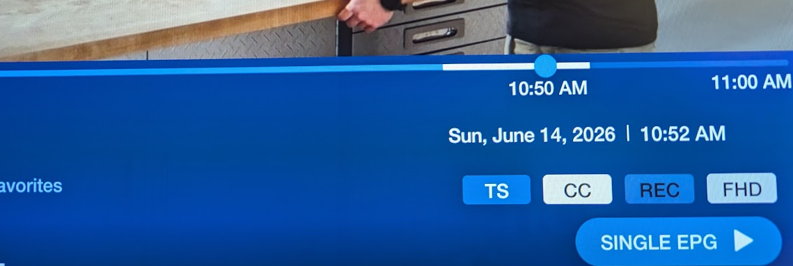

Other that that, it works fine.  Attached is a quick snapshot of it in work a few minutes ago.

Change image to remove liveTV pic to avoid issues
