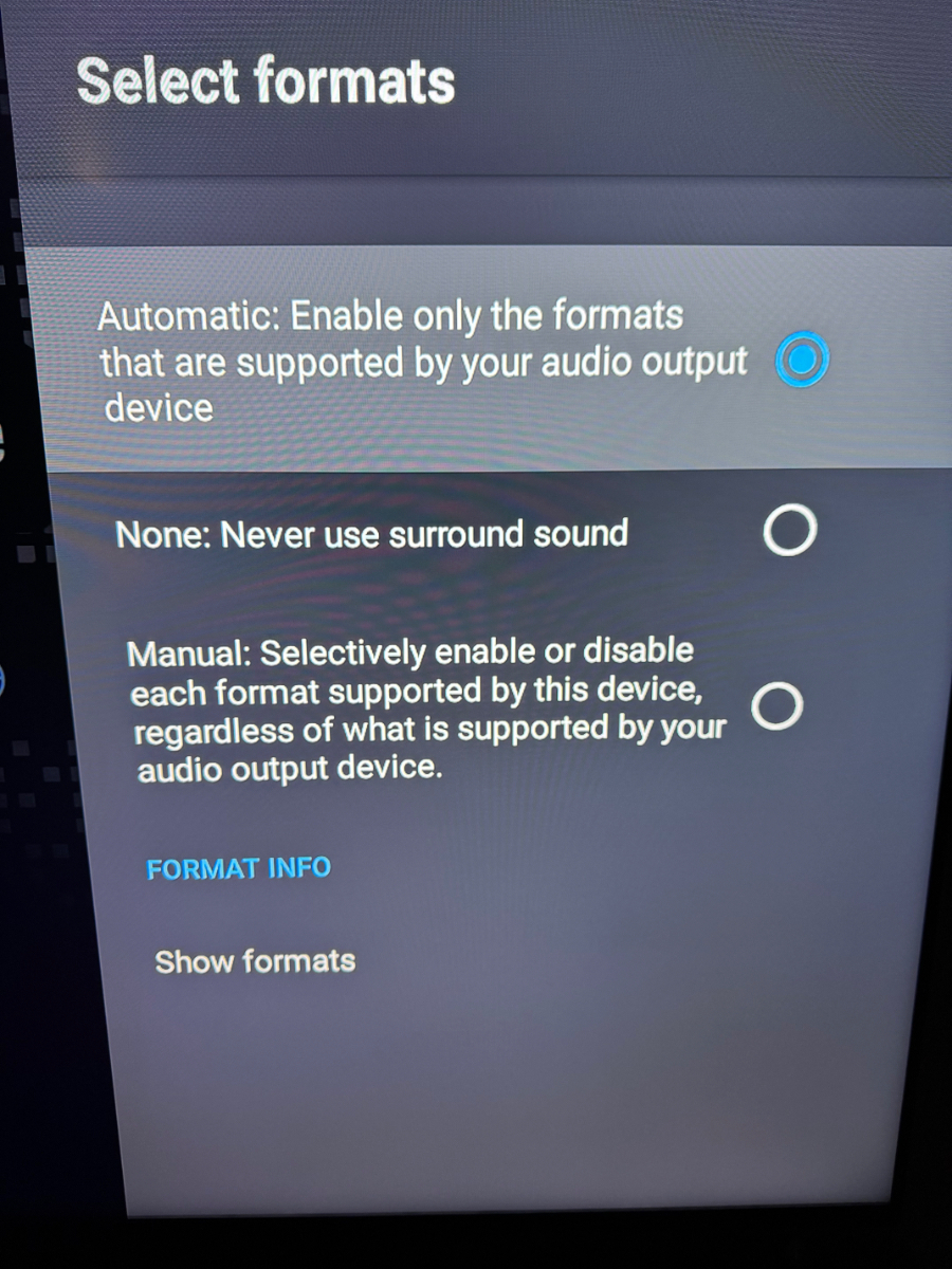

Advanced audio doesn’t stick
Whenever the box turns off or restarted the advanced audio setting changes to “none” . It won’t stay on automatic unless I change it on every reboot or when I turn the box on.

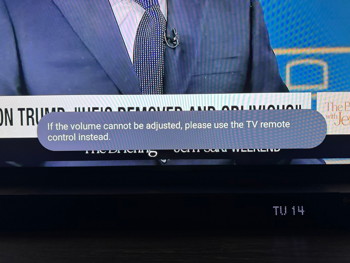

6 minutes ago, chillenandy321 said:
I also get this popup when changing volume. Volume works just annoying popup..
I assume this only pops up when you use automatic ?  I don't think this is show when you use "never".
This is probably because the audio stream is not being processed by the box (format it does not decode), but being "passthru" to whatever receiver/processor you have to decode and therefore it does not have the ability to change the volume on it, you would need to control the receiver/processing device for that.
Most who use receivers to process their audio will typically set max volume setting to true on the buzz box, and then control the volume of the TV/Receiver/soundbar", not the variable output possible from the box.
Yes it happens on automatic and using a Klipsch soundbar. It only does it on certain channels with Sparkle or using Stremio , Nuvio it will do it. Using pass through from my Sony X90L TV. If I set max volume on the Buzz box the volume from Buzz remote will not work at all.
Do you know why when restarting the box the automatic changes to none in advanced audio? I have Onn box on the same TV and have zero issues with audio. Thanks so much for the help 🙂
