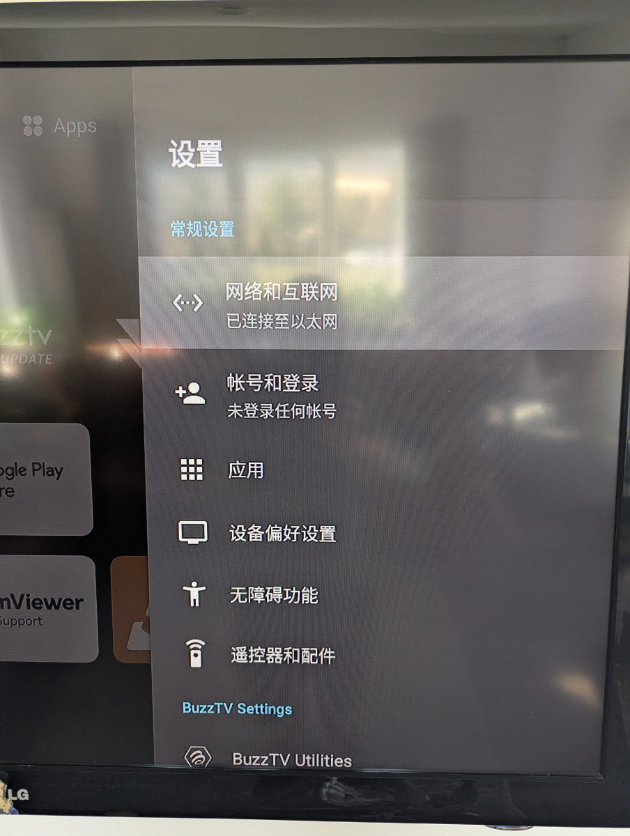

Settings all Chinese Language regardless of change.

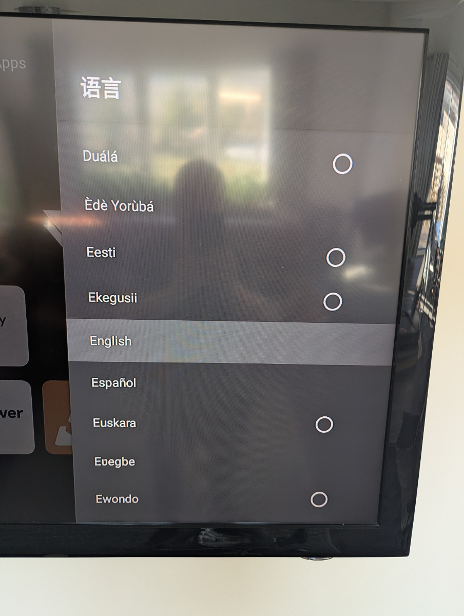

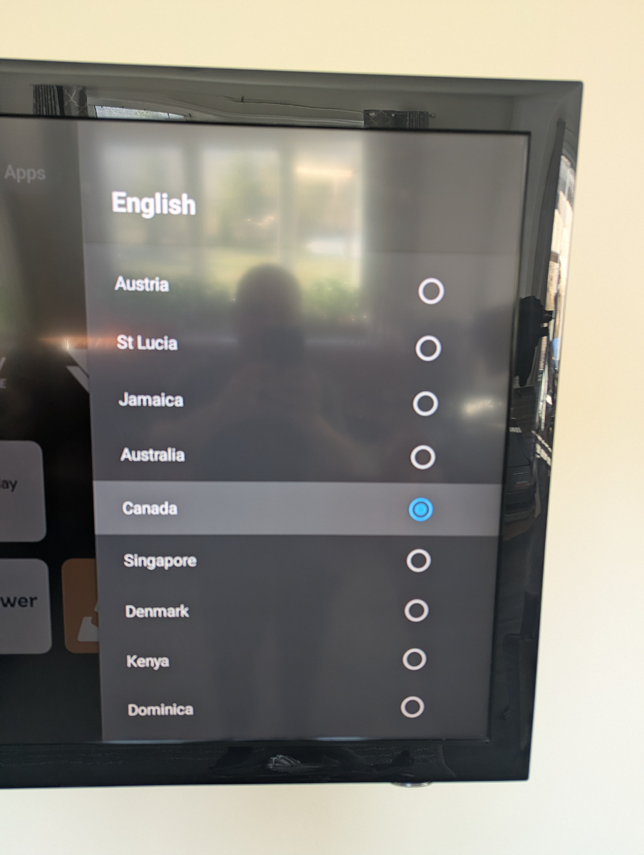

All the language in the "Settings" menu is all in Chinese. I have figured out how to navigate and change it to English by going to Device Preferences - Language - English - Canada.
But all sticks until I use the Power off Mode in the Power option menu or the Suspend option and then goes back to not remembering my choice of English and keeps defaulting to the Chinese language.

You’ve tried everything I would have suggested. You might have to wait for the dev to reply if no one else has a solution
go to CEC settings and see if you find auto language change options there. if yes then turn it off and see if that helps.

Ryu is correct From the dev
HDMI CEC
Their tv is Chinese
So the CEC is selecting Chinese as the language
Have to change a Cec setting
lol
That worked man. Something I would have NEVER thought would influence my past issue.
