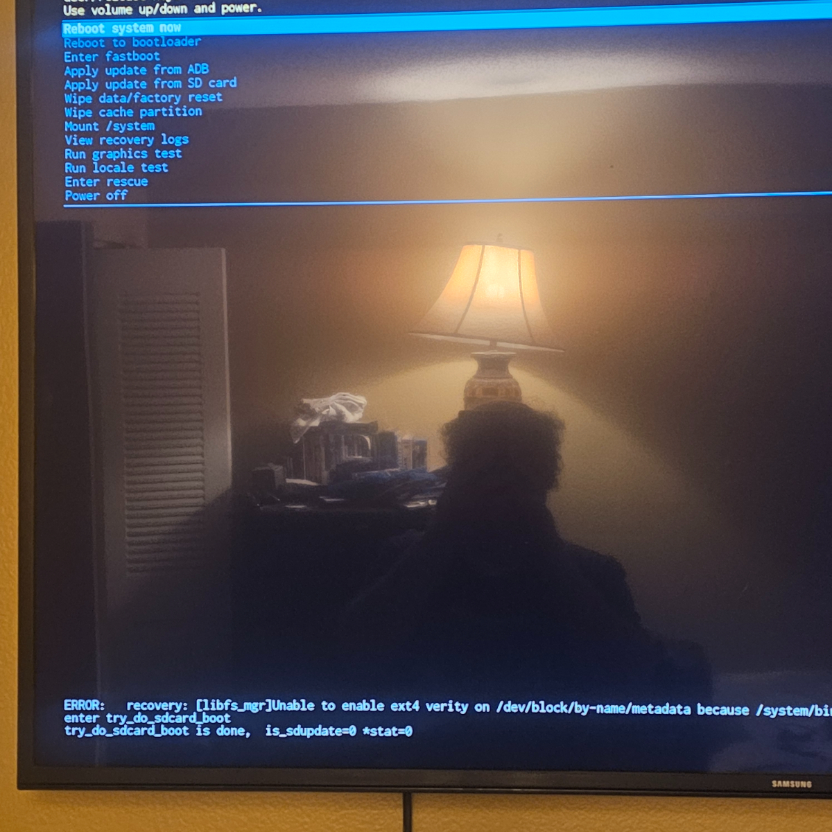

I can't boot
I did  a factory hard reset and now I can't reboot in the home screen
what do you see on the screen? do you have external devices connected to the box? do you have ethernet connected to the box?
remove stick then try to boot and if does not help them try to perform reset without nvram
I just tried it without the stick in still getting this screen
click wipe cache partition first then click wipe data/factory reset then reboot system now
I'm assuming you don't have any MicroSD card installed in the box either (easy to forget it's there since it is nicely hidden) ?
No I just did factory reset and reboot now like I done many times before and this is the first time this happened
Is there a way to download the last update and firmware to a usb and boot from the usb to get it to boot
