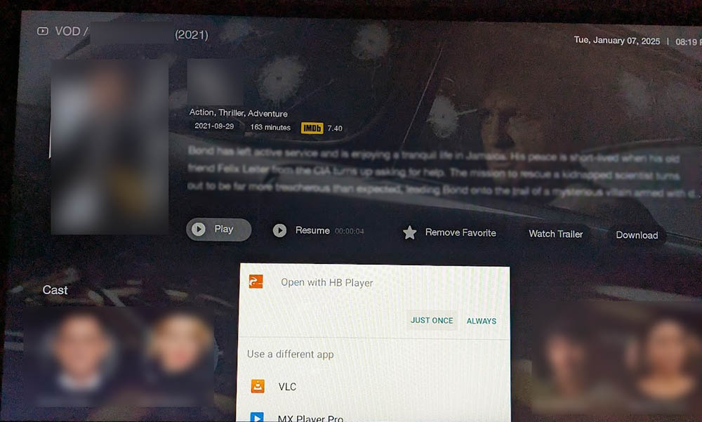

The X5 should already have VLC preinstalled (assuming you did not remove it).   And external VLC can only be used for VOD/TV Series.  And when you select it and then choose a movie to play, you'd get a popup, asking you to choose a player.

Regarding the VLC player, yes it is already installed.  I am not getting the pop up asking to select the player when I select "external" for vod.

Not at home right now, but I was pretty sure the FIRST time you try to PLAY a VOD after you select "external" it will give you the typical android prompt at the bottom to choose which player to use and you select "once" or "always" also.   If you select a player and "always" then it doesn't ask you subsequently.  Otherwise how does it know WHICH external player to use ?  I am pretty sure during testing I have used VLC, MX player and even the simple HB player.
Well, I just checked and after switching to external player, and selecting a movie and hitting play, it does give me a popup/selection window at the bottom to be able to select one of my installed external players (like I mentioned, I have VLC/MX and HB installed) so I have a choice.  If I select "just once" when I choose, it will ask me every time.  If I select "always" then it will no longer ask me, and launch the external player automatically.  Since I do a lot of testing of different media, I typically select "just once", so if a player has issues, I can easily select another player and try again.
I just have the default VNC player which was pre-installed.  I don't get a pop-up but I do get an error when I set the vod to external. I will try to get a screenshot of the pop-up message and share
