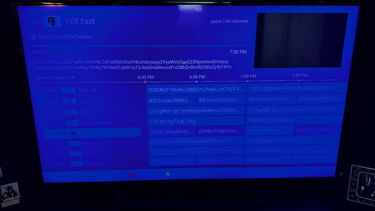

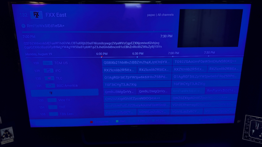

9 minutes ago, Corey Skipper said:
just installed and my guide is completely scrambled. you can not make anything out.
It's all encrypted to protect you 🙂
On a serious note,
  • FIRST: From LiveTV Try hitting the menu->settings-configuration and then under Guide/EPG, select the "Clear EPG" option.
  • SECOND, if it does not work, from home screen, go into settings->apps, and for Buzztv 6 try first clear cache and see if that help.
  • THIRD, if it does not work, you'll probably need to go into settings->apps snd do a "clear data" and then recreate the entry.
On a serious note,
I followed all 3 steps. Nothing worked, still having the same problem. I even put it in classic mode and buzztv 5 still same issue
Did you try creating a NEW server entry (just in case it is corrupted) ?
And are you sure that the issue is not the providers EPG ?  Maybe what you had before was cached, and now it loaded garbage.
If they have an app, try using thier app.  If you have XC account, try installing and using Smarters... IF you are using MAC, try STBEmu.
If you have another box, try clearing EPG and see if it reloads correctly.
I have the same scrambled info data showing. I always had since day one with this test P6.
It's only when connected thru XC.
The m3u  Playlist URL does not connect so I do not know about that data. The MAC has no data at all.
I have a suspicion these two things (the m3u not connecting and the XC data scrambled) are related in some way and issues starts at the provider and then carries thru to the P6 (Buzz6) somehow. And no I have not tried the Buzz5 yet either.
I will do that now.
 Added note : I have tested it all (including the m3u and XC and MAC) with same 'provider code'  on the X5 device and everything works normal there.
Edited by whacked
okay, so I entered the same info into Buzz5 thru XC portal and the EPG is showing the correct info, not scrambled.
Did you try creating a NEW XC server entry ?  Just to make sure it did not get corrupted somehow ?
I did yes.
Have tested triple checked my entries. Same entrie will work on other Buzz device.
I know m3u and XC work with P6/Buzz6 as per other's reports. That's why I am suspicious it's not an issue that begins with the provider I use and maybe our poster does too. Certain quirks have taken place in the past with Buzz device and this 'provider's m3u code or something, Buzz team has dealt with it directly before, so I don't think they are un-familiar that quirks can happen with this provider , something about their m3u formats or I don't really know 🙂
