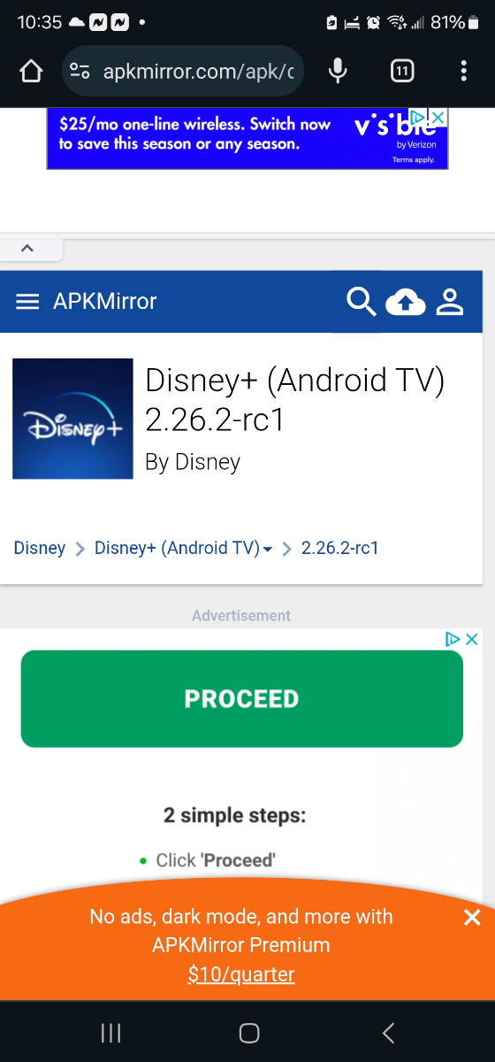

It seems that that the x5 won't play disney plus in 4k but i can can on my u5
I use the one that was posted a while ago that you need to download
