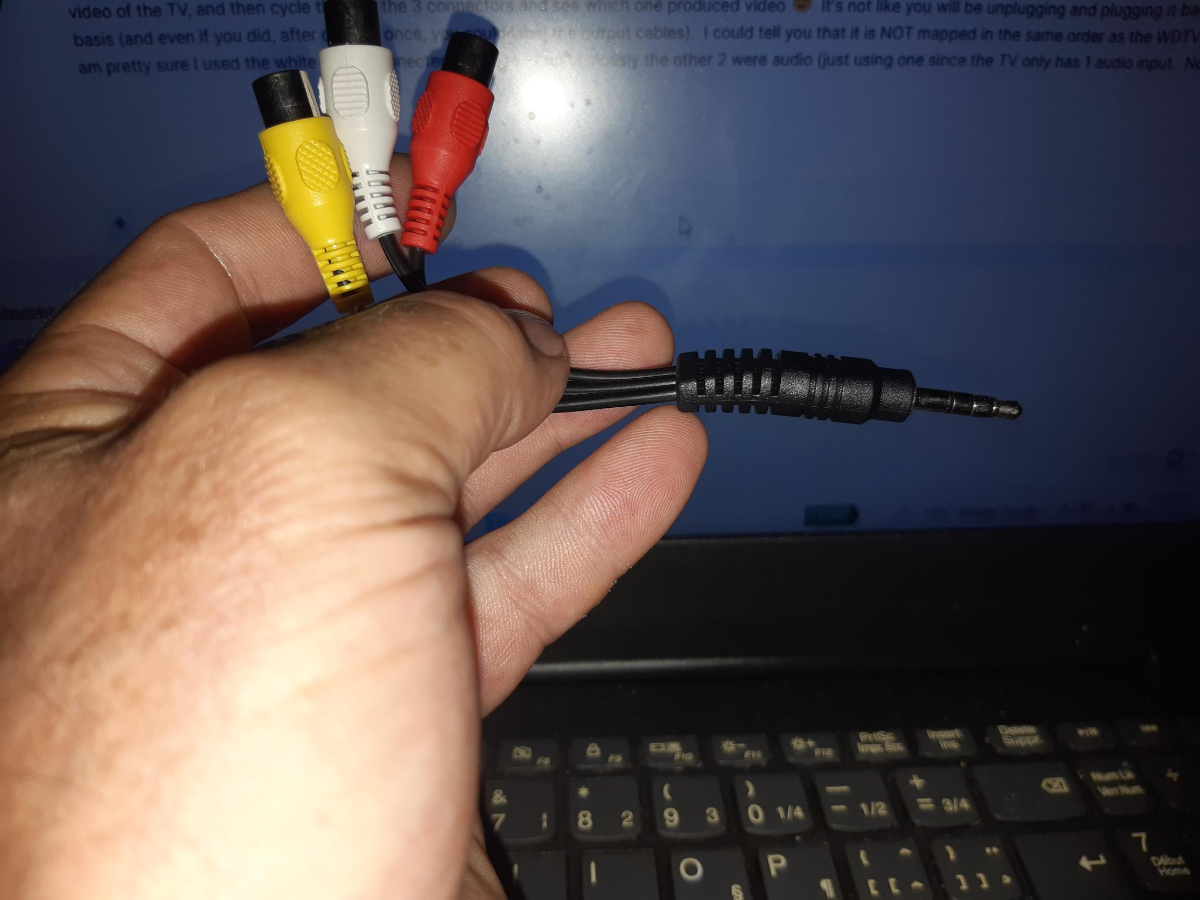

OK.. I just pulled the cable from my TV and buzzed it out (no pun intended) 🙂   Obviously took into consideration WHICH colors I was using for Video
Most importantly, I found the portion closest to the base of the jack is Ground (connected to the outside of each RCA connection), then followed by Video.  Then the 2 tips, I can't comment which is left/right, but that is for sure no biggie.
The WDTV is GRLV (from base of connector towards tip).   When cable connected to my Buzz, the Red is my Video cable, so Buzz is either GVRL or GVLR (Base to tip).  Either way, at least you know where the ground is, which is the most important (something I overlooked on my first comment of this thread).
Hope this helps you make the correct decision.   Not sure dollar store cables even list the pinout unless it is some good quality overstock they are liquidating 🙂
Just be carefull that the 3.5mm connector is not too long.  I have one which the base (ground) is quite a bit longer than the usual (don't even recall where I got it).  So it makes it VERY tricky to use.  IT works, but you can't insert it all the way.. Need to insert and then pull it a mm or 2.  If you get it off a little you get audio humm...  The WDTV cable was perfect (except for the order of the VRL connectors, but that was simple swap.

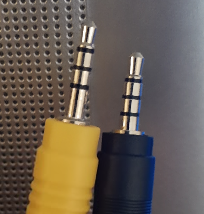

Just for clarity, this is what I mean by my last comment (connector too long):
One on left is too long.   One on right is the one that I am actually using.
