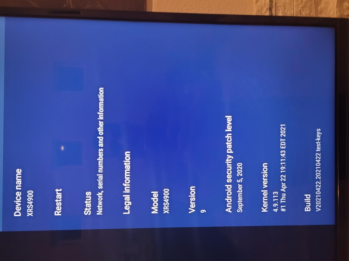

What firmware version is on that 4900 model ?
The original firmware had some issues with Playlist URLs and m3u files. They fixed the issue thou with upgraded firmware. I think that was how it went, but was awhile ago and may have been a VOD Playlist only.... but check that version anyway.

In meantime, Check your Firmware Version
The latest should be v 4.0.549
If you do not have that version then ask allaboutbuzz to assist with that.

I attached a picture of my build version etc

I have the 4900 with the latest update (20210422) I am unable to load my iptv into the Xc api. It just times out. Can you help? Thanks
