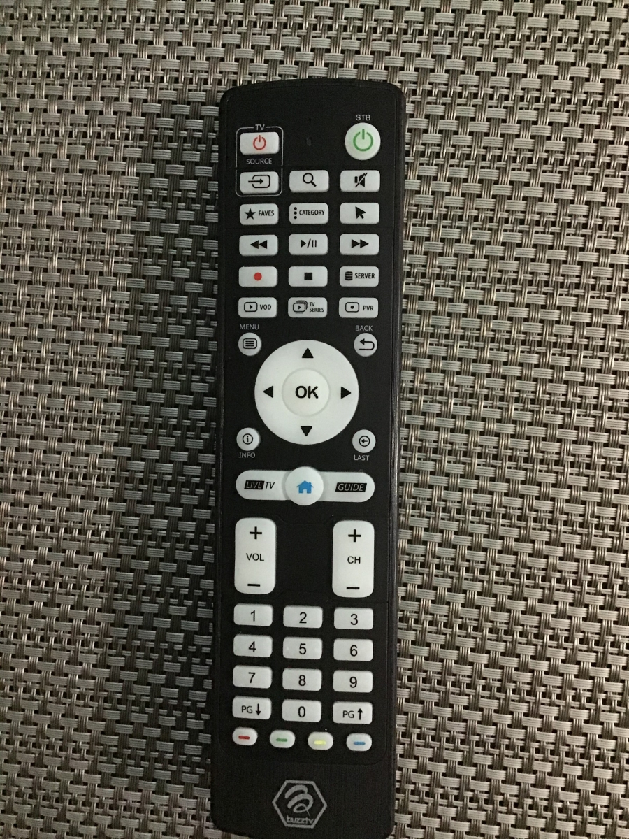

  4. What I meant to say is that there is more complaints about the same issue with the remote that comes with 4000 models. so even if he can get a same remote model replacement, the problem will probably still be there.
  5. I don’t think it is just one defective remote. Way too many people have exactly same problem, I am one of them. As a workaround I use a Buzz 2000 remote.

  10. To confirm hdv’s finding, I moved my buzz 4K to an older, non-smart tv and the original remote works fine. I was flipping through buzz for 10-15 minutes and no delays at all. So, it might be an interference from a tv after all. Btw, the tv I was having issues with is a one year old Samsung. Hope this helps the Buzz team further troubleshoot this issue.
  11. I had a BuzzTV 3000 remote and it worked like a charm with my Samsung tv. Two Buzz 4K remotes ( original and illuminating) both have these issues though the illuminating less than the original. A fake buzz remote from Artronix also works without any problems. PS Buying a new tv to fix remote problem is not an option 😉

  20. @allaboutbuzz, do you know if the new 4000 boxes are shipping with this remote now? Or if a fix for the original remote will be released? I want to buy few more for friends and want to make sure they don’t complain about the remote. With this remote, I’m finally 100% happy with my BuzzTV XRS4000! 👍
  21. Just a quick update: For all of you annoyed with the original remote that comes with 4000 boxes, I just purchased a remote for Buzz boxes and it works flawlessly. It looks more like the original BuzzTV remote than the previous one I posted here https://www.amazon.ca/gp/product/B082H5TVRT/ref=ppx_yo_dt_b_asin_title_o00_s00?ie=UTF8&psc=1 BuzzTV IR-100L - Luminous Remote Control for BuzzTV XR4000, XRS4000, XR4500, XRS4500, ST
