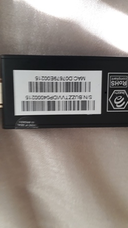

Label on back of VidStick reads:  MAC Address – d0:76:79:e0:02:15 (see attached pic)

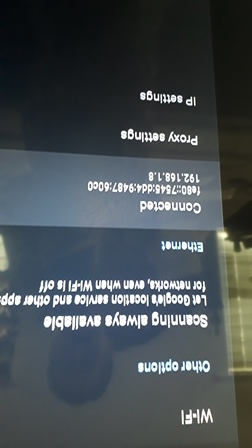

Ethernet connection MAC address reported by BuzzTV 4 software:  fe80:7545:dd4:9487:60c0 (see attached pic)
I’m not sure what’s happening with MAC address printed on the VIdStick Plus label as compared to the reported results I encountered using both the wireless and ethernet connections.  The ethernet connection seems work OK; however the internet speed received is much less then my usual 220mb download speed.

Buzz have stated that they only support their usb adapter with drivers so that could be your main issue
the mac addy on stick will match device id in server settings
the new software coming out will be reduced to one id line
