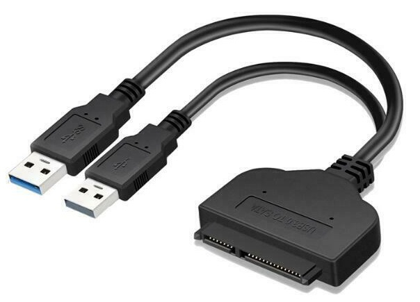

I have an USB 3 adapter like the one in the picture below.  They work like a charm for Sata 2.5" HDD and SSD.  A have a few of them which were freebies ages abo with some retail boxes Intel SSD drives I had purchased.  Typically only need to connect the usb3 connectors, but they are handy for those devices that need JUST a little more juice since you can also plug in the second connector to any other port to get a little more power.
