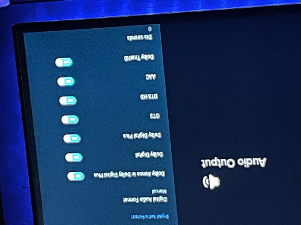

everything works with my buzztv 4900xrs which is setup the same as my x5 which only outputs pcm and not Dolby Digital 5.1, Dolby atmos or Dolby Digital Plus…
here is a screenshot of the audio output from my 4900 which works perfect
but the audio output from my x5 is S/PDIF, which I don’t know if everyone’s x5 shows that or it’s what it’s supposed to show
