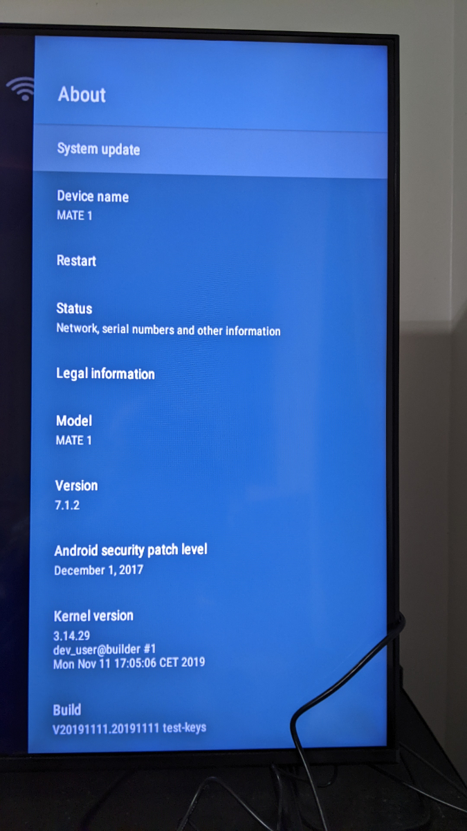

I am stuck with quite a few Mate1 boxes for that is the my main reason to have a original firmware on hand .  I had one but I can't located anymore.
one box keep popping up "Bluetooth share keeps stopping"
Another one is stuck on red light front of the box and tv doesn't detect
please help me finding the any firmware whichever will work with Mate I "boomerang"
Thankks
and ver 7.1.2
build v20191111.20191111 test-keys
kernal ver 3.14.29
dev_user@builder #1
mon nov 11

I just got my buddies Boomerang Mate 1 to try to update it (has been powered off for ages), but obviously nothing on server (not surprised consider how old it is).
Current state is: V20190207 with V2.0(239) presently installed.
Did a hard factory reset ,I tried installing the buzz 352 software (as posted above) which I already had and used to update his (and mine) old xpl3000 [and had no issues with the xpl3000 units], but it gives me an error "BuzzTV 2, App not installed.  The package conflicts with an existing package by the same name".  Tried installing from Appinstaller and File Browser that are preinstalled.  Not sure what package it doesn't like, because the main package on the mate1 seems to be com.boomerang.* while the buzz ones (including 352, are com.buzztv.*.  So maybe it is some common dependencies.
All I really wanted to do is install a later version of BuzzTV 2, so he has the "streaming line" option, to be able to use it with w$%^#d and XC connection.  The xpl3000 after updating to 352 and enabling streaming line and credentials works fine.  A little slow (by todays standards), but it works quite well.
Even tried checking recovery screen if there was some way to install the apk by forcing it, but I did not find anything.
However when I used to have an old boomerang myself, I could have sworn I had taken an update which pretty much rebranded it to a buzz box, and even replaced the boomerang logo on the top left with a buzz logo.  If that update was still available somehow for use with a microsd card to update the box, that would be great.  I really don't want to install something like "smar..." app to use it with XC API.
Damn... All I have to say to Buzz team is WOW & huge thanks with this old box.
Emailed CS, and after a little back and forth and nearly had just given up (not a biggie since it is an old box), they came through.  They managed to find the last firmware they sent out to the MATE 1 (which essentially rebranded it to a Buzz) and they sent me it, I managed to install it with a USB key through recovery and the box now works like a charm.
The firmware brings the box up to Firmware V20200326 with S/W version 2.0 (354).  I just remembered, they also sent me the APK for (357) which was the last version the released for the MATE1 I believe.  I did not try it after the firmware update (since tried it before the firmware update and it would not work due to other API/dependency issues).  Tested it with MAC/ XC and M3U and works fine now.
