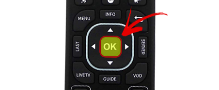

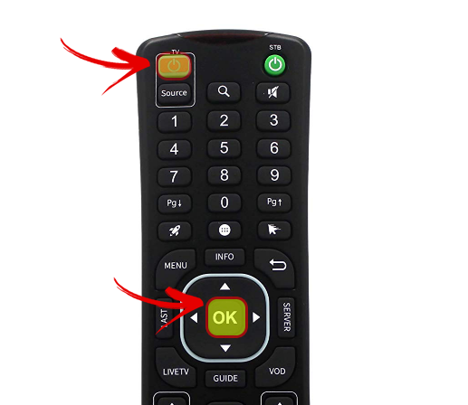

1.Press and hold TV+OK for 3s till LED turn solid on and RCU enters learning mode

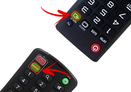

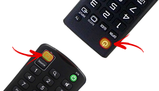

2.Press the key to be programmed on this RCU. LED begins blinking
3.Aim the TV RCU towards the front of this RCU(distance less than 3cm)Press the button on the TV RCU,if the STB RCU is programmed
correctly,the LED will flash 3 times then turn solid on
4.Repeat steps 2-3 for other keys
5.Exit learning mode by long pressing OK button for 3s,LED flash twice then turn off

Thanks for the fast reply with a solution. That is how I have been trying it but it never did take. However, success this time. The new remote is working my volume and power to the TV.
Thanks!
