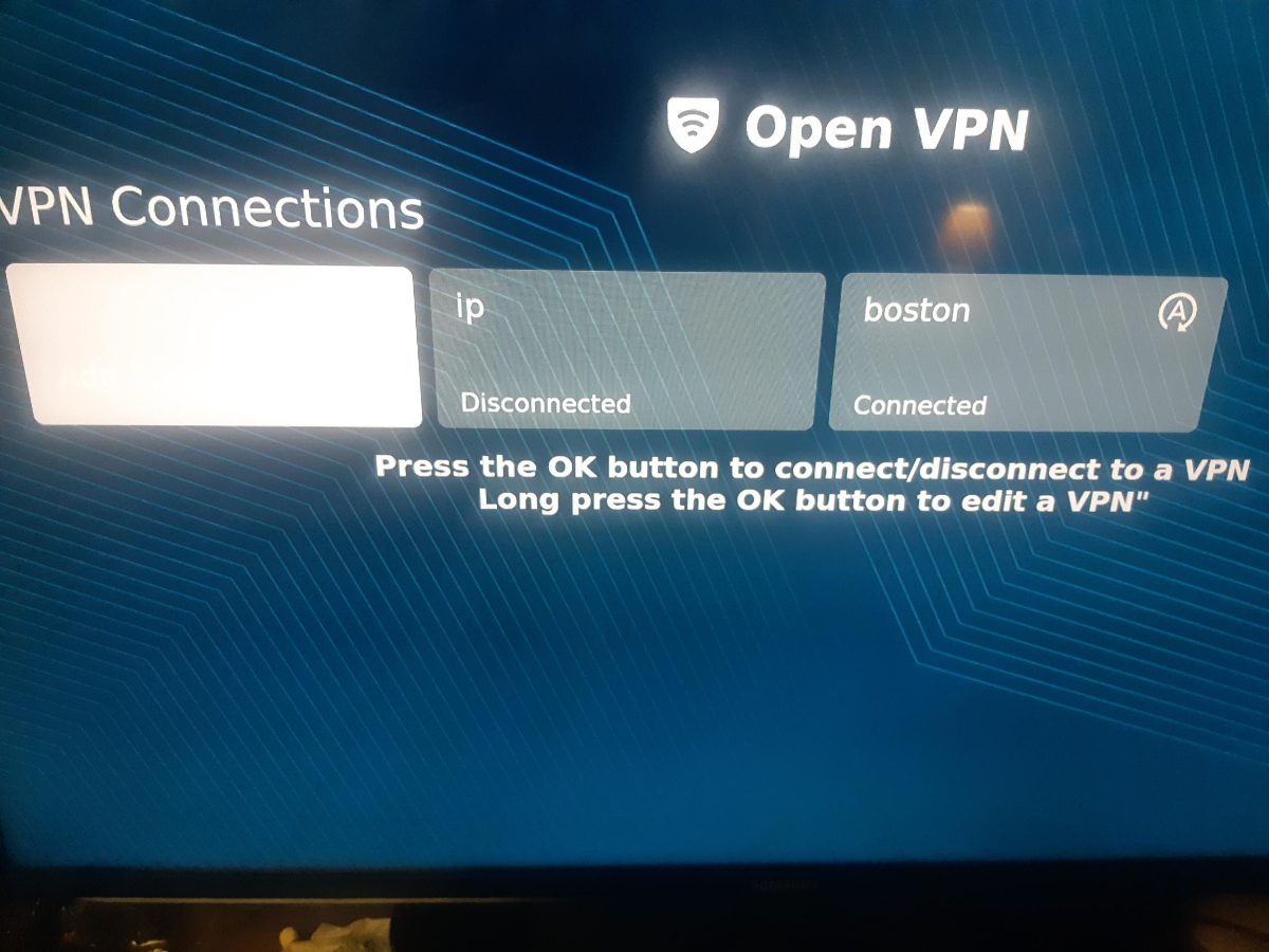

I don't seem to be able to crack this. Loaded the config file on to a stick to import on the box, enter my credentials and it just goes back to the VPN Connections screen. If I turn off "Use Credentials" and try to connect, I get an error message that says Not connected to VPN.
you don't load the  whole config at once
you load a server location one at a time
I spent more time editing config than loading it
I don't know if it has been fixed, but there was a UI issue, hat even if you load config, sometimes it doesn't show until after a reboot.  I had played with 4 or 5 server config files and I had issue with them.  After reboot, all the configs showed up and the ones that didn't work before, ended up working.  I did have 2 or 3 configs that didn't and I need to run more tests (and provide the details), but after importing configs, try a reboot (either way, reboot on this box is like 10 seconds 😃 )

are you selecting add vpn and the selecting file?
then picking a server location and naming it and save?
