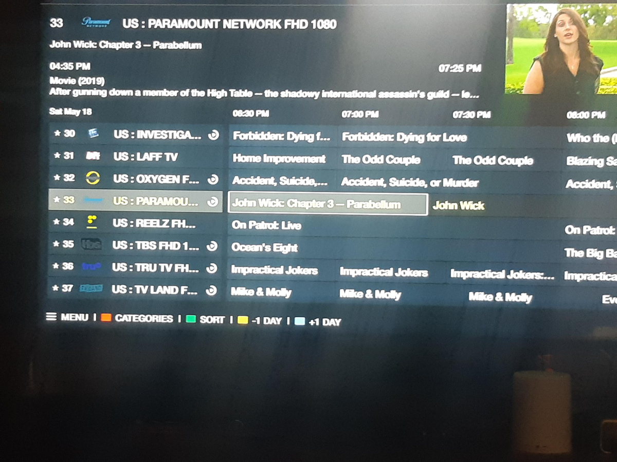

I get 7 days of epg on all channels using server epg on xc api connection

Same here.  XC login, Server EPG (xml works fine also and seems quicker, but server is most up to date), and I have just a little over 6 days forward and the Buzz has cached 7 days previous also.
