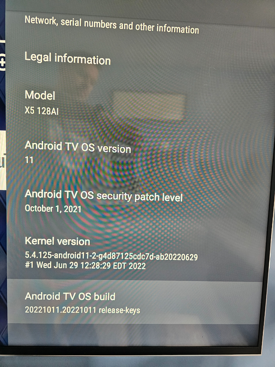

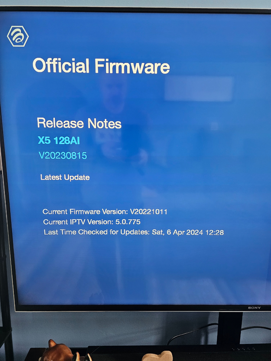

On 4/6/2024 at 1:06 PM, ThrasherPrime said:
Here is what I have going on. The person from their help area that wanted me to send now says I'm good. But the software version is wrong. I still think the firmware is wrong. See attached photos. 20240406_122827.thumb.jpg.9fd120787aad4e17f3a48364c8389dbf.jpg20240406_122752.thumb.jpg.a65ea09652fb10f4c9bd8ba3807e245b.jpg
On 4/6/2024 at 2:01 PM, Emporium said:
True.. But I don't think the firmware update took.  Maybe downloaded (hence the release notes), but it did not actually install.
Considering the box is back up and running, I would not probably do a PIN method factory reset one more time.  This would clear all cache and prep for latest update.
On 4/6/2024 at 1:58 PM, dishuser said:
and you're in wrong screen to check for software updates
On 4/6/2024 at 3:22 PM, Emporium said:
I say, you got nothing to lose at this point 🙂
