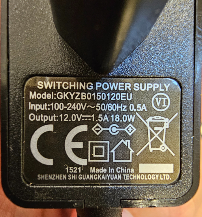

Power supply for U5, 12v and how many amps?
The U5, what are the USA  power requirements for the U5 in regards to amperage? Does it require more for hard drive usage? Does it matter internal or external on amp ratings? I did find one post that stated that the U5 power supply is 12v 1.5amps, is that true? I lost my power supply in a move. Thank you.

Actually, it will probably turn on, but it will be quite unstable with strange behaviors.  Many have had strange behaviors with their box, only to realize that in their rush to connect it their new toy, they "assumed" the power supply was the same as other boxes and didn't swap out the 5V power supply (from thier previous box) for the provided 12V.
12V 1.5A or greater should be easy enough to find.  They were pretty common also on external powered USB hard drives also.  I have a box full from a few from old LaCie and Seagate external drives and they work fine also on my U5 and 4900.
